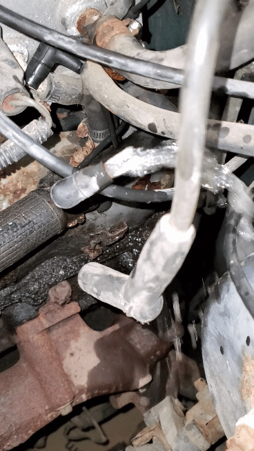

Thank you Ron, I looked up the diagram and you were correct. The explorer vac line runs to the the drivers rear of the intake. I got inside and cycled the key a few times went out to the vac tree and pulled one line off and realized that it did not go to the fpr, I followed the correct line and pulled that off and boom fuel pouring out of it. Looks like I am at least one step closer to fixing the issue! If you weren't in Canada I'd buy ya beer or two! Lol

Just for future reference for anyone else. I replaced the regulator, changed the oil, plugs, and wires and she starts up and runs like a champ! Not what should come out of a vac line!...
