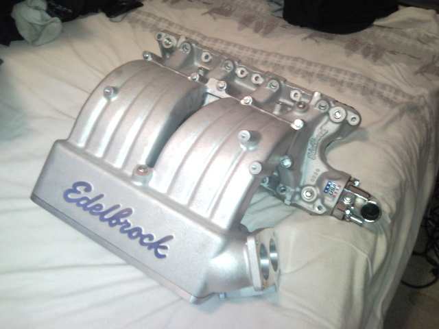

This Is what im trying to put on ... its not an option to put mustang intake ... I bought some '91 mustang heads that I was thinking might solve the problem they were only 40.00 so Im not out much

is it an sas truck? do you have a 3 in body lift?
its a good torque intake for a 4x4.
the car intake is easier to use, but you will have to modify your truck harness to work with the car intake(or just get a car intake/pcm) as the throttle body ect are located in a different location, and will want car fuel rails as well if you are using the truck harness and rails.
a straight axle truck will allow a x member that can let the engine down a bit more so that truck system will fit nicely.

Is it (your motor in the truck) a dual or single throttle body?
That intake in the pic isn't for a Mustang, nor will it fit a Mustang because it will hit the hood. It is much taller than the factory. Mine is one inch taller and it rubs the fiberglass sound deadner. That intake is an F-150/Bronco intake.
