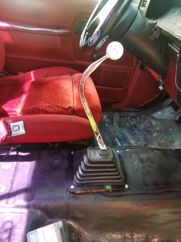

it literally puts it right whwre it needs to be.. Its disassembled right at the moment.. putting it together. But mock up.. its perfect!
Unless he ised a s10 tail housing its back about 8 inches from the stock local.
How was the shifter placement in the cab?

The picture above... the shifter may be where it needs to be for you, but it looks to me like it is much farther back than factory. Look at the shifter base. It doesn't even sit within the factory tunnel cover. If both seats were in it would be between them. Forget it if you have the 60/40 split seats.
But thanks for posting the pic, it shows where a foxbody Mustang T5 shifter will come up very well.
EDIT- Just reread the posts and realized JungleJoe made the comment about perfect location but picture is from RamCharger90.
It isn't horrible and it will work with bench seats. I have seen trucks with benchs and T5s before. If you are concerned about OEMish location s10 stail housing it. Or go with a M5odr2 even then you need a certain year range for a 4.2L v6 or you need a custom shifter like I needed before.

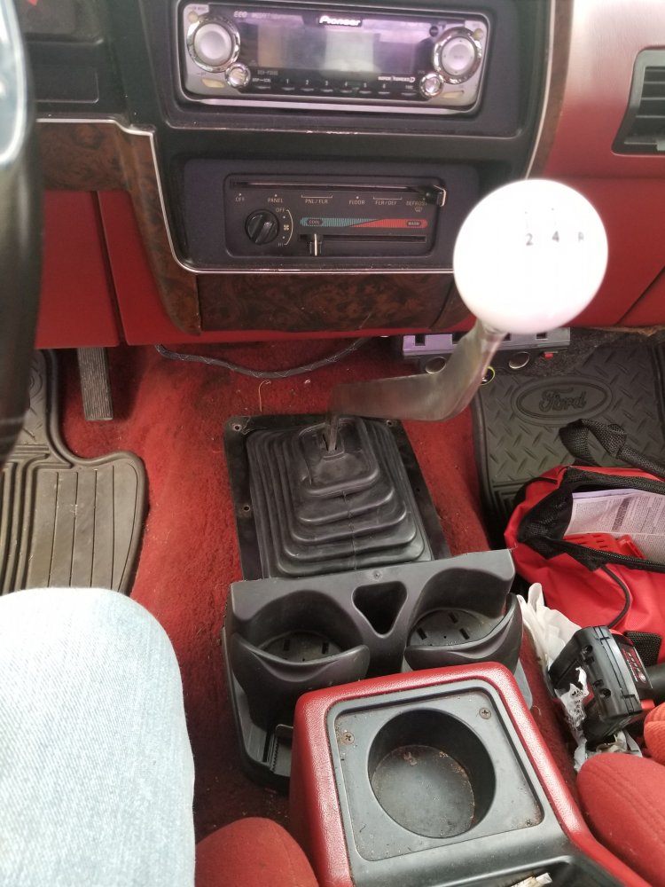

46225
It seems like the shifter location is closer to dash with your t5 or m5odr2 then with my old 2.3l trans.mine literally sits right in front of your console does now without your floor cup holder thing u have there.old post figured id reply a tad later.

It was closer to the dash with the m5odr2 it was from a 88-95 5.0 f150. Thats why I needed the custom shifter. I hate none oem looking stuff also but custom car some times you have to sacrifice minor oem details
