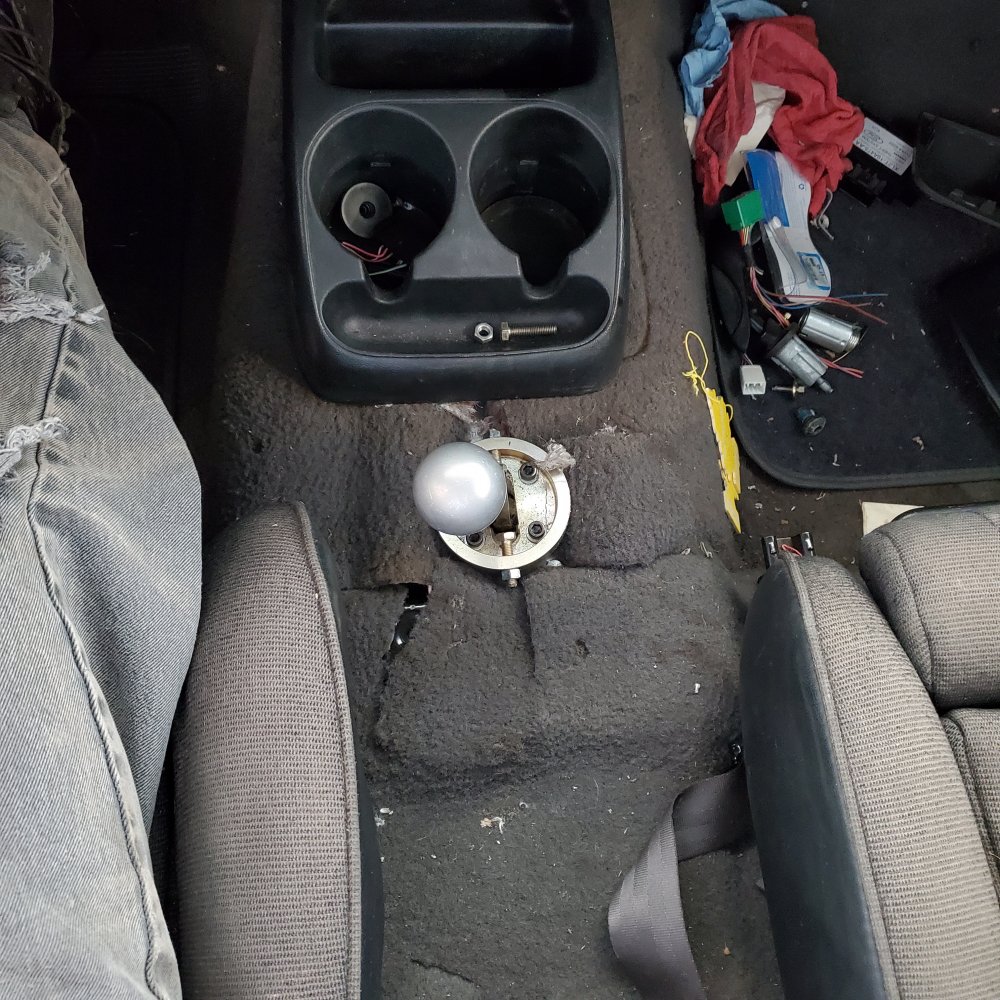

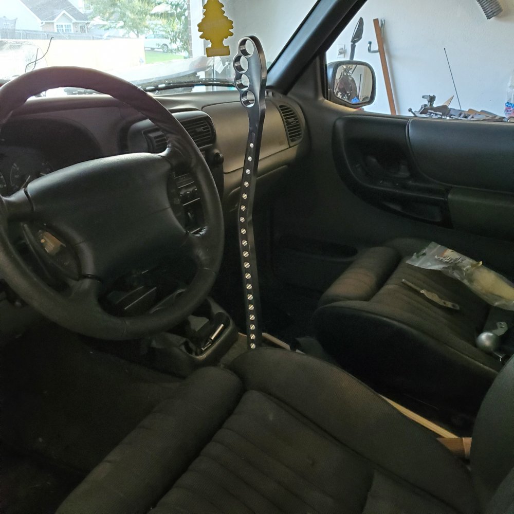

It was closer to the dash with the m5odr2 it was from a 88-95 5.0 f150. Thats why I needed the custom shifter. I hate none oem looking stuff also but custom car some times you have to sacrifice minor oem details
So that pic wasn't with your t5 in your truck?how close to console does the t5 sit now? Have any pics of where it sits with t5?

I like the T5 a lot better than the Mazda transmission. A Fox body uses a shorter input shaft and bearing retainer than a 94-95 SN95. The Fox body bellhousing and trans will move the shifter around an inch forward and is more common/cheaper. 4.2 V6 F150's were extremely rare around here and I never liked the way the m5od shifted.
So the sn95 t5 will be a tad further back then your foxbody t5 setup?
It's 5/8" farther back. Probably wouldn't even notice the difference.i had a sn95 t5 in my fox body and it was fine.
I have buckets with a center console in mine.
