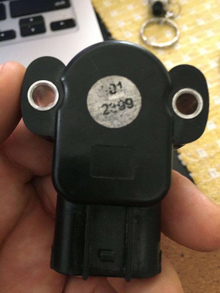

I have a 99 4x4 with a 5.0 swap from a 96 Explorer. The previous owner seems to have replaced the TPS plug and put in a new sensor. It has a P0122 code.

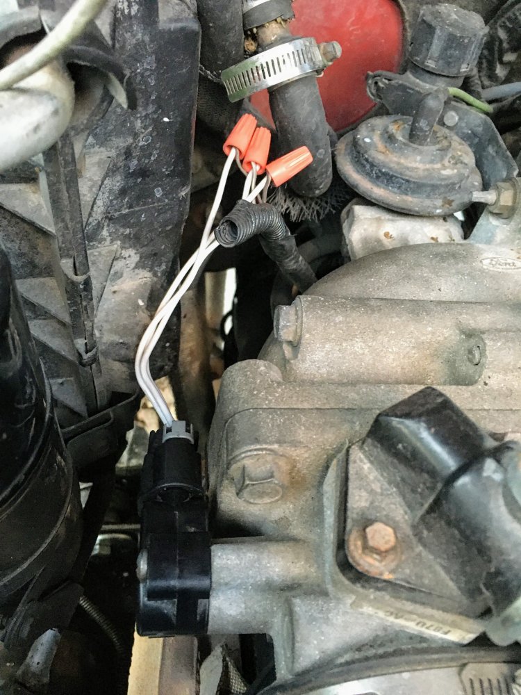

The engine harness is from a 99 Explorer - not sure if that makes a difference in this case.

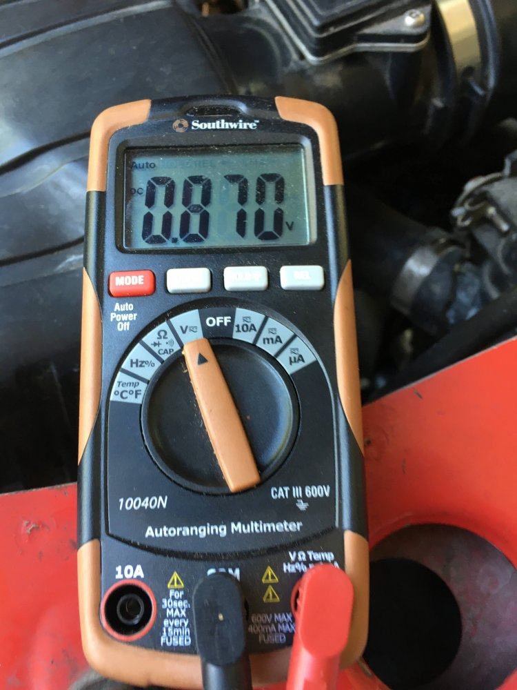

I've tested the sensor - it does have low input voltage (.87 volts - throwing the P0122) but seems to increase and decrease back down smoothly when opening and closing the throttle body. Tapping on it while opening/closing the throttle does not seem to cause any erratic behavior. Wide open reading is around 4.5 - 4.6 volts. Reference voltage seems fine.

I do have it temporarily wired up - I wouldn't think that I'm having a voltage drop due to that. But maybe?

The guy in my book says to take a jumper and jump the 5v reference voltage to the signal wire. Then see if the first code you got goes away, you should get the tps voltage is too high code. Just to verify the wiring and the computer are working correctly.
