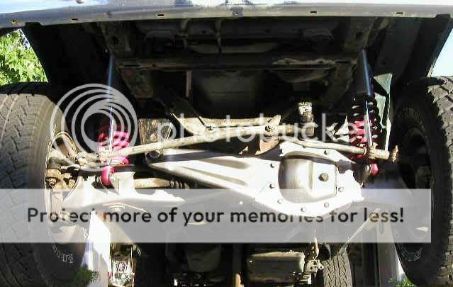

It's obvious by peeking at your front axle. It's either the TIB (2wd) or TTB (4wd).
Here's 2WD Twin-I-Beam axle:
Here's 4x4 (Twin-Traction-Beam) axle:
