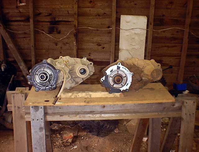

a dummy case is basically and empty transfer case common on the 87-90 Bronco II(saves you from changing rear shaft,and tranny output, though if your 4x4 T-case is a fixed yoke in the front you can leave it in there, which is rare) DS is Drivers side drop bracket, to my understanding on the 4wd its on the outside off the engine craddle, on 2wd bronco II and explorers its on the inside,
but the 2wd bronco II and 2wd Explorer(91-94) use the same engine craddle as the 4wd rangers, the rangers are the odd-balls, some reason ford switch the engine craddle between 2wd and 4wd rangers(83-87)
dummy case on right
