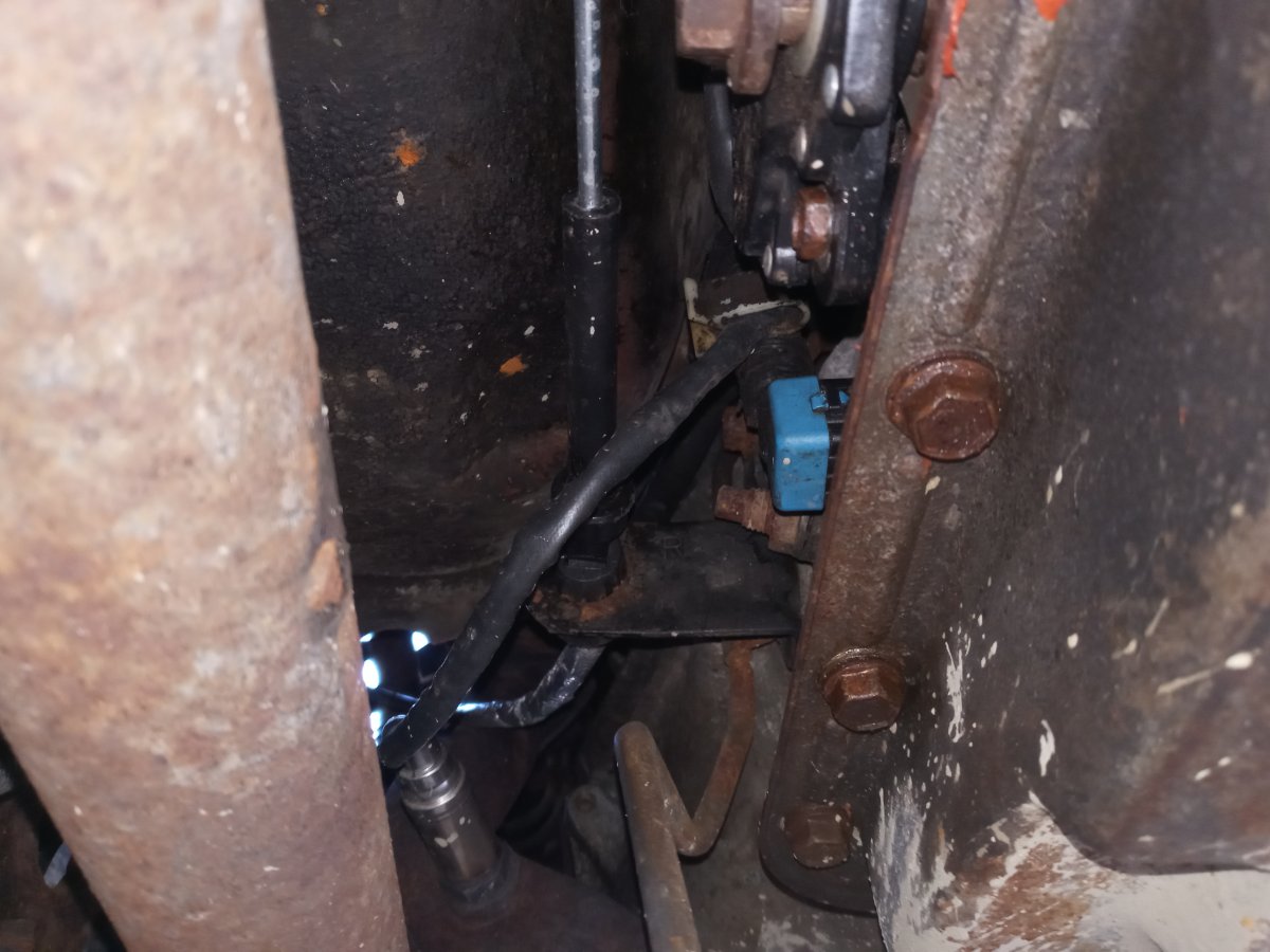

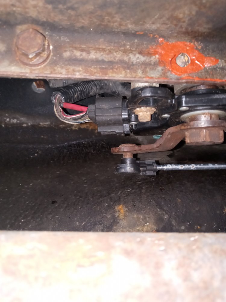

So this one??? Or this one?? Or neither
No, neither

And just FYI
1st picture you posted is the 16 pin automatic trans solenoid connector, computer controlled shifting
2nd pic is the DTR(digital transmission range) Sensor, tells computer what "gear" driver selected, also operates Reverse/Backup Lights, and passes Starter Motor activation voltage if in Park or Neutral
