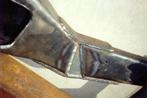

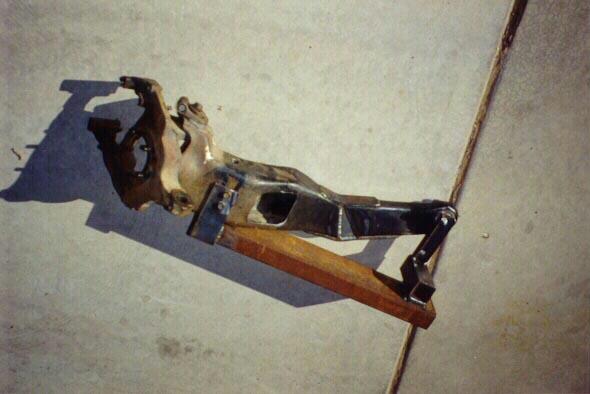

I did both..
Here's why..
I didn't like the U-Joint angle with only extending the lower ball joint. Plus I would of had to cut a lot of material from the passenger axle passage way to obtain the wheel travel I was looking for.
And I didn't want to lose tons of ground clearance with cutting and turning like the zimmerman's.
So I found a balance point.. I did both....
lower bj, by its self is good for up to 4 inches of lift IMO keeping the camber bushing as close to 0 as can be. want more lift, you can use the camber bushing but the axle shaft joints start to get on the raged edge. along with the KPI(king pin incline) tends to want to pull the axle shafts off the outter clips.thats biggest problem. with anything past 4 inches.
1.5 drop brackets really help alot, aka stx/hyrider brackets. if you want 5.5-6 inches of lift. Also help with the plunge on the slip yoke on the axleshafts too.
if your carefull and take your time,you dont have to hack out of the axle port.
how my port is notched out, that is with the short beam on metal(bumpedon the frame) and the drivers hanging lose.
I run stock axle shafts, but Im also stock width.
Ive done my share of crawling around in low range, wheels cranked hard and lots of throttle,my best impressions of AWD drifts on dirt roads in 4hi and havent had a problem yet with the shafts. nor do I expect to,due to the bjs being kicked out on the beams.
