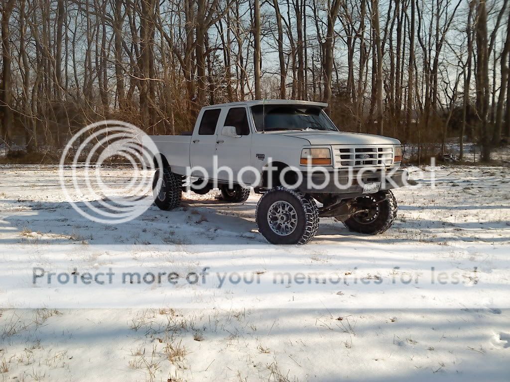

Was this what you were looking for minus te 5spd?
4wd Conversion on 1997 2wd Dually 7.3L PSD
I also had the reverse shackle kit on mine. It wa made by pmf fabrications and it was simple to bolt on
Yep. Pretty much. Was looking for something closer to stock height tho.
Nice rig!
Thanks sold it a few months back. Still kicking myself in the butt for that one. It was bone stock when I got it. The pmf rsk was 3.5 inches with a 4 inch superduty spring. The ride is 100 times better with the rsk
