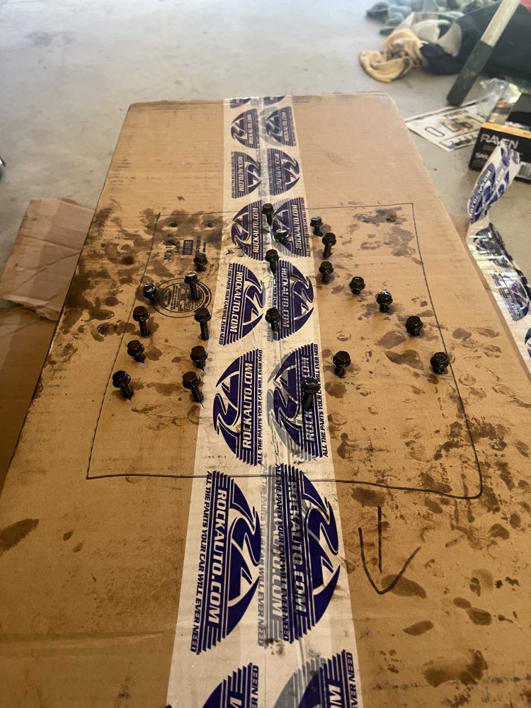

If you’ve had that slip or that reverse delay. Go ahead and tackle it.
Only trick is to be sure to track what bolts came out of where for reassembly. People show their tricks. Basically, use a box and a sharpie

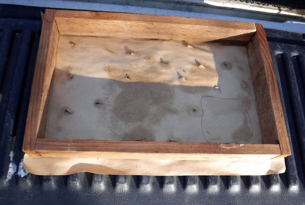

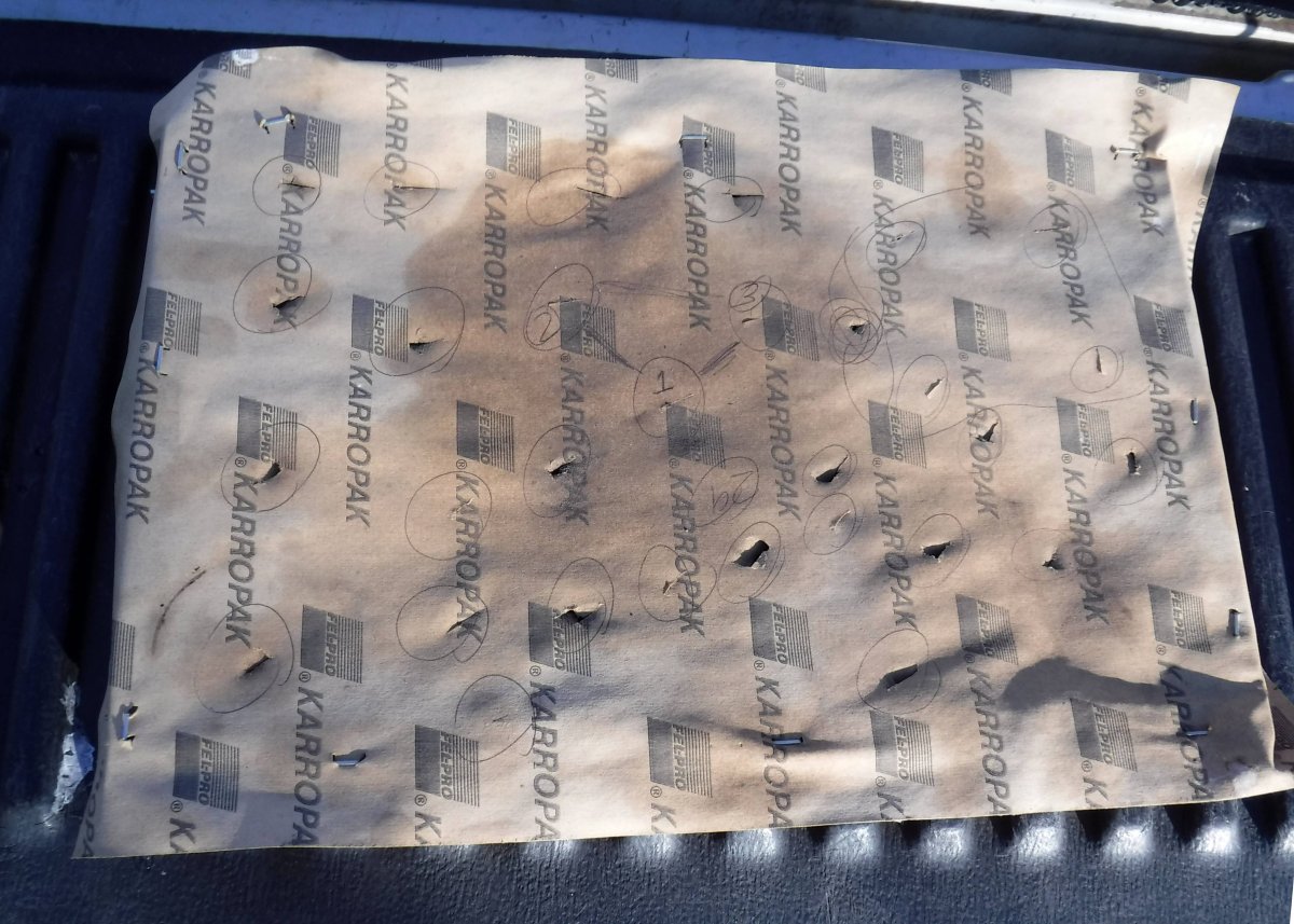

Here's something I came up with.
Made a frame type thing and stapled some felpro gasket maker on there.
Not sure how I layed out the circles
if I get some mixed up I put them in holes where it takes about 8 turns to snug it up.
process of elimination eventually puts the bolts in the correct holes.
