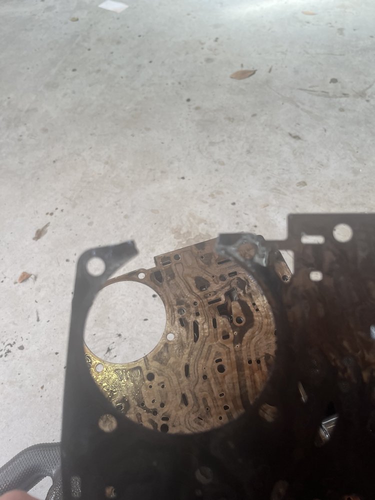

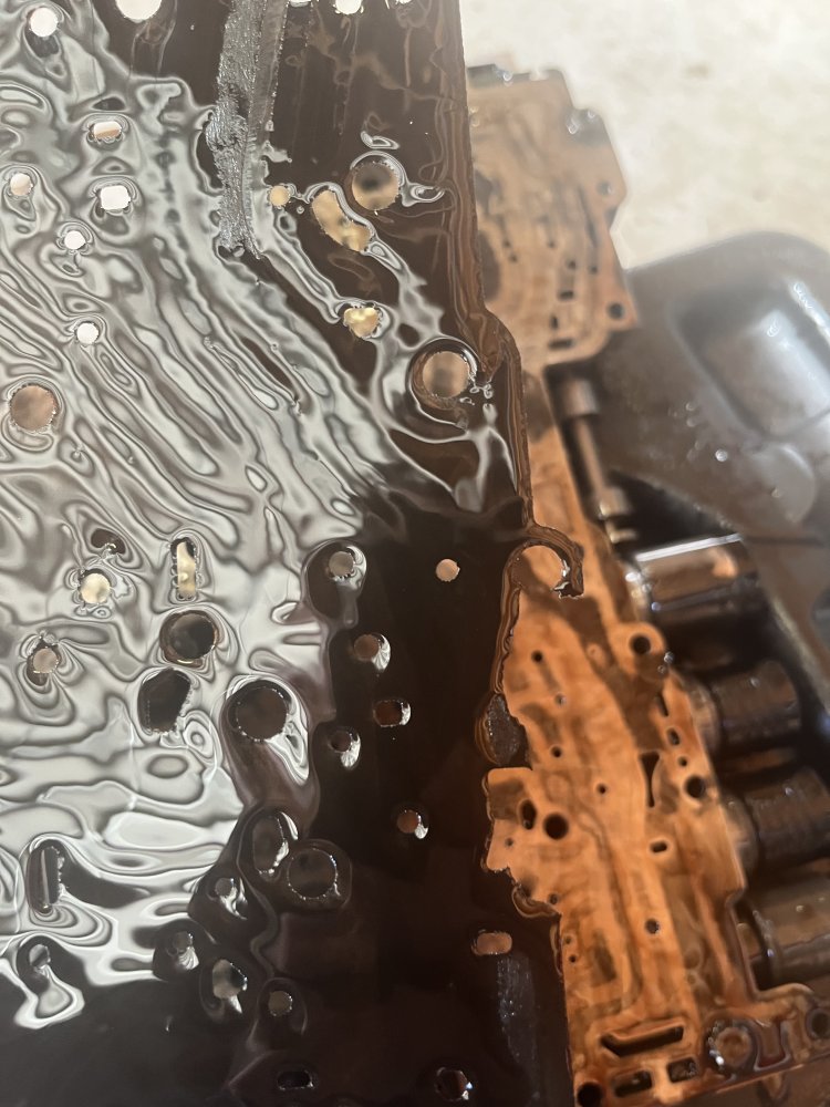

So I put it back up there as clean as I could. There were two gasket failures inside
  • 4R44E - is it that easy?  And question.
