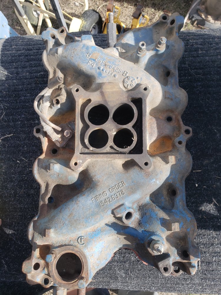

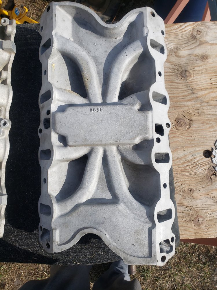

Pics of intakes;
Edelbrock Streetmaster single plane lowrise
Weiand Stealth dual plane hirider
Stock 1968 dual plane lowrise
View attachment 75619View attachment 75619View attachment 75620View attachment 75632View attachment 75622View attachment 75623View attachment 75621
For what you're building, the stock cast iron lump is closest, the Stealth might be a little too big and hurt low end. There's a reason why the Street Master is no longer produced, it worked pretty good in the mid range but a Performer works better down low and at least as good through the mid range, a Performer RPM/Stealth style dual plane works better from the mid range on up.
