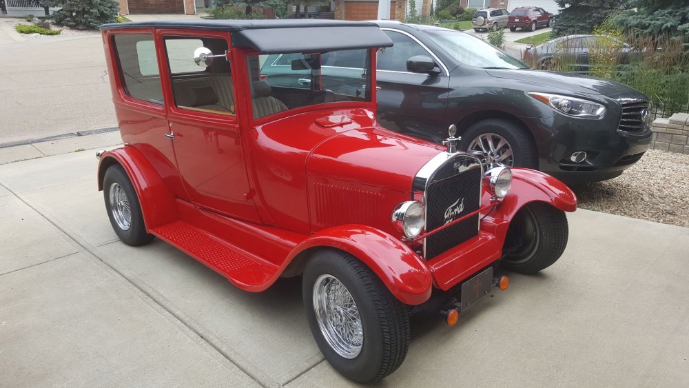

Hi everyone, i am doing something different. I had a 2.8 v6 out of a 1975 mustang in the model t that was very tired.

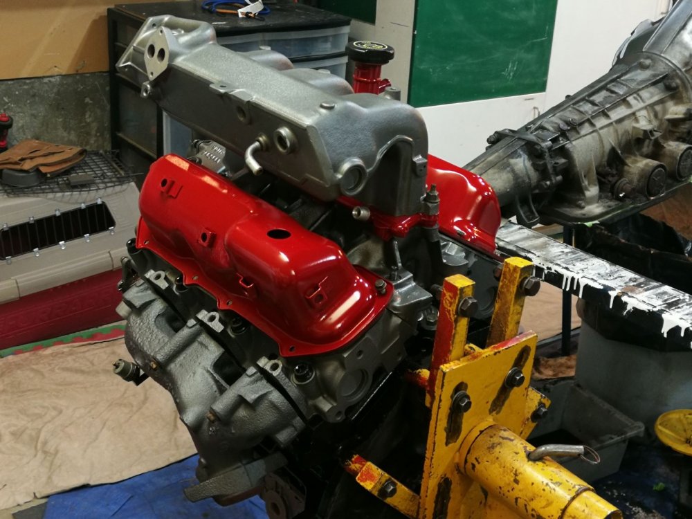

I have owned a number of explorers over the years with 4 liters in them. Very reliable and more then enough power for me. I stumbled across a 1992 ranger 2 wheel drive with a 4 liter, and a4ld trans. Stripped the engine/trans, engine/trans harness, and as much of the complete harness as i could out of the ranger.

Thank you. I have the engine and trans in, just swapped out the pinto diff for a 1995 mustang 7.5 with disk brakes. Starting on the wiring next.
