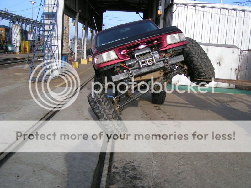

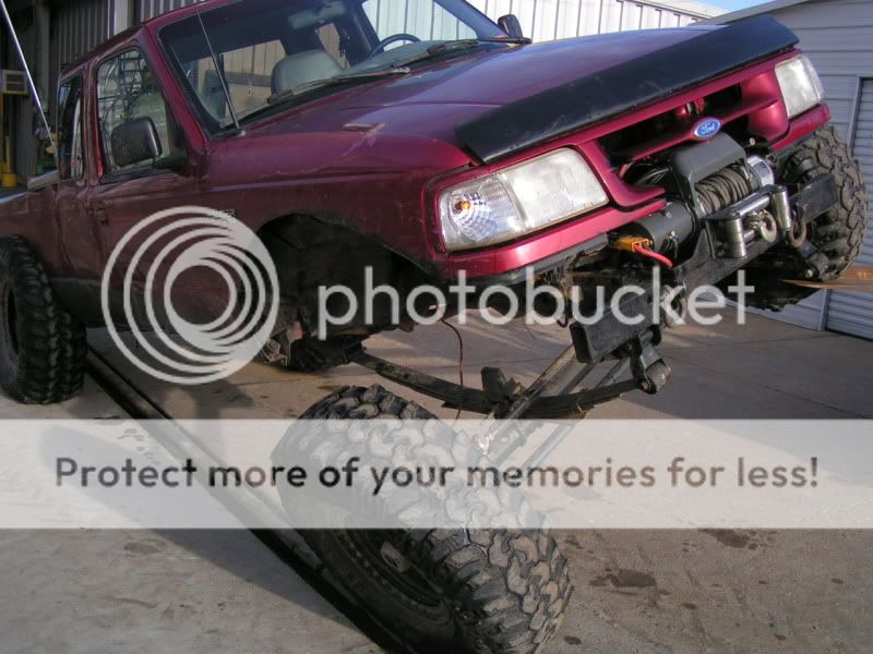

I have been running mine since late November on leaves....have a minimum of 12 wheeling trips on them and no issues/sagging so far with the 39.5's....and I think they are pretty flexy:icon_thumby:

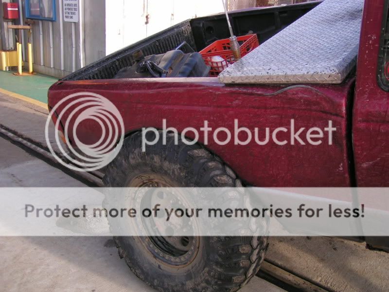

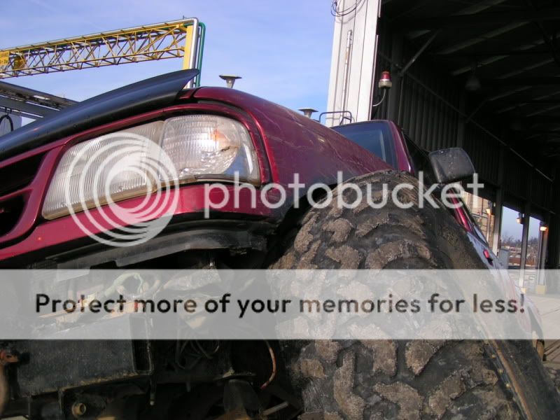

as you can see, this was with the "1st cut" of the fenders....I have since cut them again since they made contact....then used my pliers to "roll" the lip...

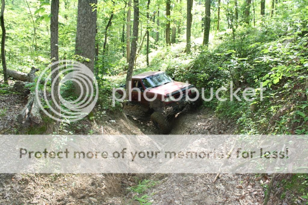

Some photo's from one of the other guys I was wheeling with.
