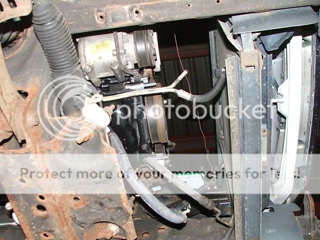

Yes from everything I can find online it will fit with electric pusher fans. Possibly needing a slight push of the radiator under the core support.
5.4L in this one pic the 5.4L is 23 5/8" long vs 27 1/8" for the 6.8L according to sullivan. That is normal clearance to the firewall and should clear the radiator with an extra 4"
