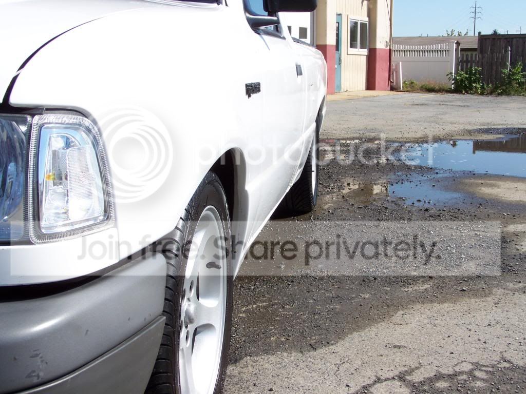

Here's the pics as promised! Let me know your input.
wow that looks real good now you just need a better looking bumper to go with it.
cool i guess
Word dude. i have a 2" front and 3" rear drop kit coming in the mail. its nice, like others have said it needs roll pans ad a bangin system. also i would say loose those lame svt mustang wheels and get some 20" black rims. yours are kinda small... plus white paint with black rims, lights, ang tint would look clean as hell.
lol didnt see the system stuff youve done. sounds like a nice little setup
that thing looks sweeeeeeeet. makes me want to drop mine.
