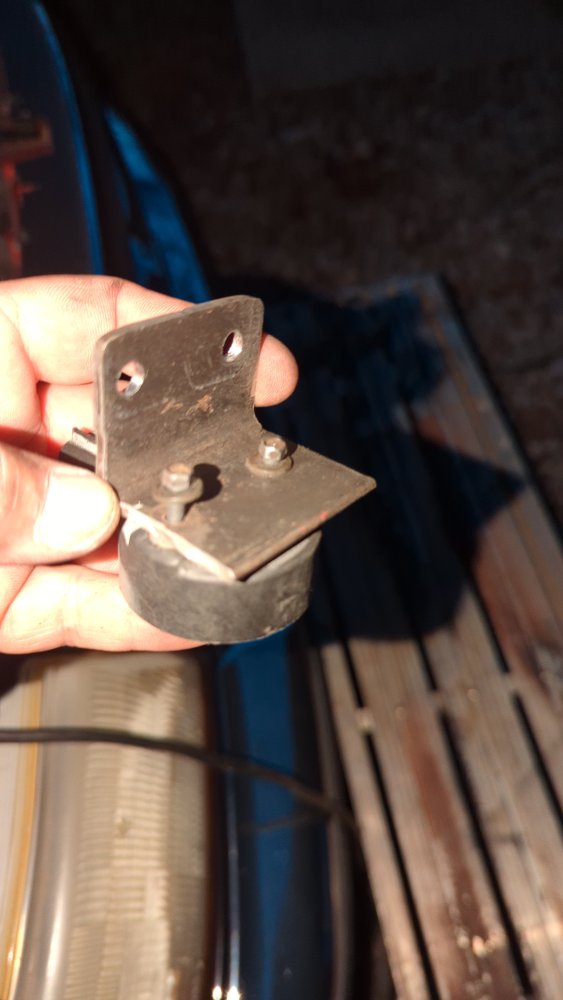

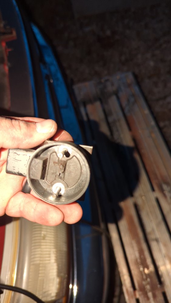

I Have 1998 ranger with the 4.0l and I'm trying to change out a bad camshaft synchronizer. I can not get the synchronizer to move at all, the casting won't rotate and I can't pull it out. Does anyone have a suggestion? I've pulled the upper intake to access it but it is still so far down there. There is no way to grab it.
Here is some info.
The screws that hold the cap on stripped out before the sychro came loose. Slide hammer failed.

Did you ever manage to get it out? Struggling with the same issue on mine
I tried to pull that damn thing out about a dozen different ways for a month. I made special tools to grab it and twist it and lever it, but where it was located, you couldn’t get anything on it. I checked with everybody I knew, and an old mechanic friend gave me this:
Poor brake fluid all over it for a couple days. I had to make a funky angled funnel out of some paper rolled up because even that was hard to do!!
The reason it’s frozen in the hole is the greasy carbon crud is rock solid around the top and the O-ring. The brake fluid will eat that up in a couple days. Then I just tapped it sideways a couple times with a 5/8 inch wrench, actually very gently, and it started to move. Once it started to move, I could work it back-and-forth and eventually it came out. But it didn’t come right out or easily, I had to wiggle it forever, and eventually I worked it out.
CAUTION: if I recall, it’s a tiny 5.5 mm socket for the little screws that hold the electronic cap on. 10mm for the hold down screw and washer. The screws are made so they stay in the cap, but that bolt and that socket can fall right down in the hole when that synchro comes out. Guess how I know that. I have one of those five dollar telescoping magnets from Harbor Freight, and thank God, I was able to stick that down the hole and pick the socket out. It’s my own fault and my own stupidity, because 99% of the time when I’m working with something like that, I use electrical tape or masking tape and actually tape the joints of the ratchet and the extensions in the socket so they won’t slip off. Again, if I recall, right, I had three wobbles extensions on a quarter inch ratchet and a universal just above the socket, and you had to slide that in perfectly to get it to get to those screws.

You may very well be my hero; I tried everything I could think of (PB Blaster, prying tools, tapping with a hammer, heat, yanking with vice grips). I have a large container of brake fluid that still has some left after a recent brake line job, so I'll start pouring and see if your trick works. Fingers crossed. Did you lay anything out to prevent the brake fluid from dripping down into places you didn't want it, or were you not worried about it?
The replacement synchronizer I bought did at least come with an alignment tool, and I already had cylinder one at TDC on the compression stroke. I was completely ready to finish the job when I found that the damn thing was stuck in the block. I need to get rid of my CEL so I can get it registered (I bought it a few months ago), so I'm getting pretty desperate. I am at least highly certain it's the cause of my CEL because it's what the seller said he thought needed changed, and when I took the sensor off the top of the synchro, I could see that the metal tab that's supposed to send the signal to the sensor was broken. Seller probably just realized it was seized in the block and didn't want to deal with trying to get it out himself lol

Well unfortunately I haven't found success yet; it's been soaking for about a week (thanks to some bad weather keeping me from working on it), and it doesn't seem to be loosening. Although my main problem is that the edge of the synchronizer actually chipped off when I tried tapping it loose early on, so I don't really have a good way to try and hit it. Damn thing really is in the worst possible spot. I'll just have to keep trying and hope enough tugging will finally work I guess lol
More brake fluid. Maybe rig some kind of a brush, like a paintbrush with most of the bristles cut off, so it’s almost like a baby scrub brush, and wiggle it in there and under the head to try and work, the brake fluid in and clean out whatever crud. Maybe go and see what else you might be able to pour on it that will eat the crud up without eating the engine up.
