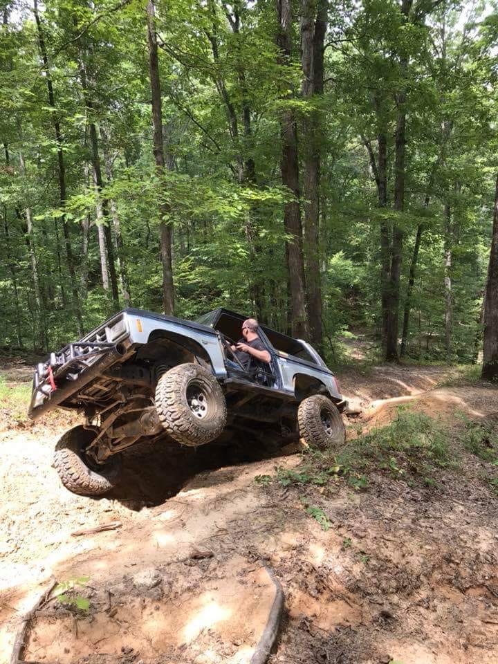

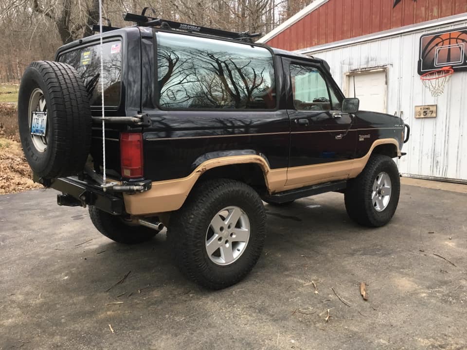

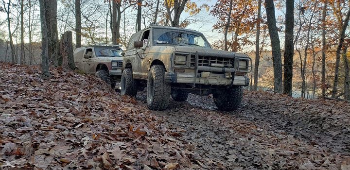

“Truths” I’ve read here:
* You can’t run 33’s on a 7.5
*You can’t run 33’s on a Dana 28.
All these rigs are on stock axles, running 33-35” tires. Everything you read here says not to. Ive talked to guys running 7.5/D28 under 302 and 351’s. It’s all in how you drive it. Be gentle. I really expect to have to rev and drag the clutch less with the added torque of the 4.0.
