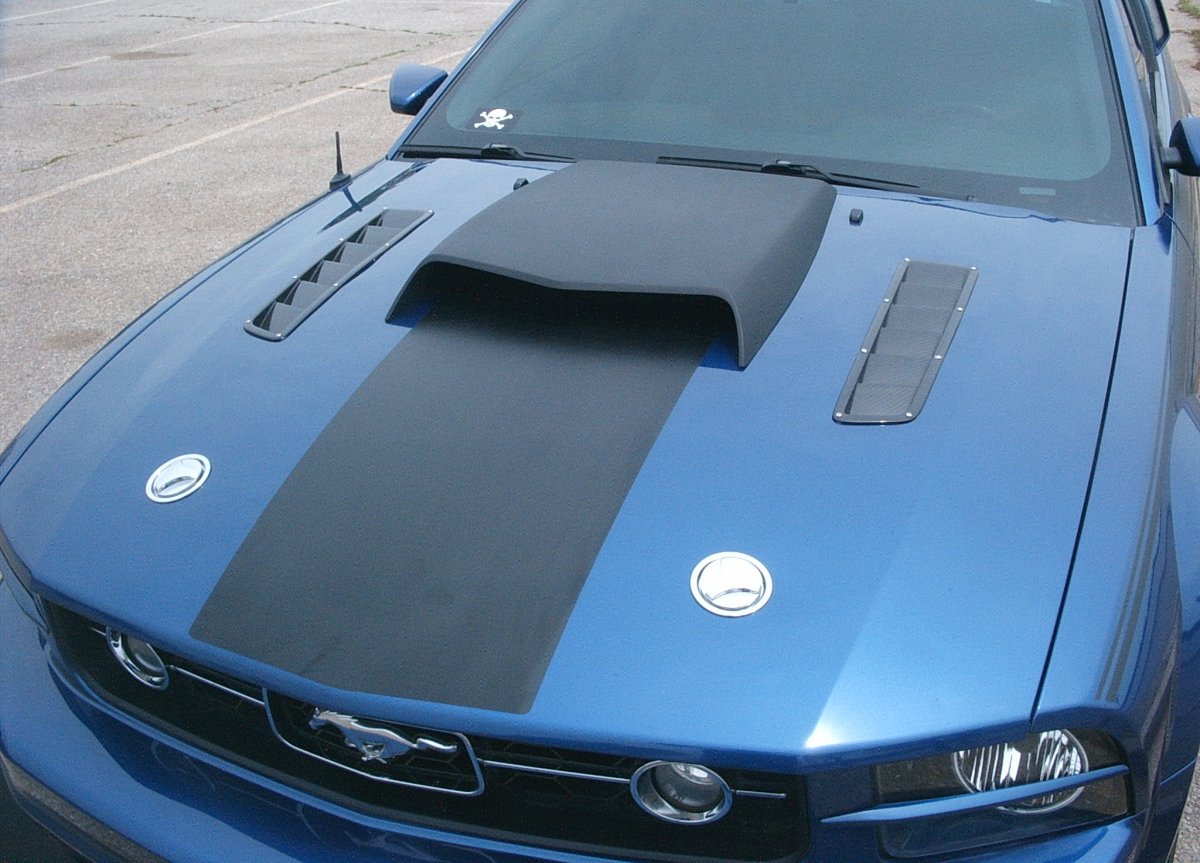

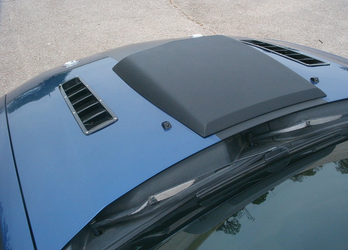

I have a 2007 Mustang with the SOHC 4.0. Heading for 123,000 soon. So far, the engine is quiet. I just finished installing heat vents in the hood, and if there was any noise, I'd most definitely hear it now. Did just have to have the 5R55 transmission rebuilt though. Not my fault. I bought it with 112,000 miles. Had the fluid and filter changed pretty quickly after, but it was likely too late. The fluid was a yucky sickly yellowish brown color. Anyhow, a snap ring broke inside and proceeded to just lay waste to the inside. Had to have it rebuilt. Fortunately, I have a friend who does such things. Cost me $2000, and that included a new torque converter at my request, as I had transmission code P0741, Torque Converter Clutch Locked Off. Also included one of Rick's homemade shift kits. And the six pack of solenoids has been replaced as well .Should be good for a long time to come now.
I'm loving it now. No more blinking OD OFF light, no more overactive tach on the highway, and I can actually feel it shift, even into OD. ;-)
