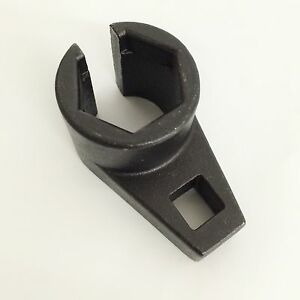

Used a SplitCrowsFoot socket during my last O2 Sensor change; worked great!
Though don't have a lot of corrosion due to salt here & soaked sensor+bung threads with penetrant overnite before taking them out.

But if you like to buy tools, the crows foot flare nut wrenches can be good for O2s
O2s are 22mm but 7/8's also fits
Don't try using an open ended wrench you will just round off the nut
You CAN cut the wires off the old O2 and slide on a closed end wrench or deep socket
Or use a flare nut wrench
You're going to disconnect the wires to install the new O2 sensor anyways. Once the wires are disconnected, you can slip a closed end wrench on.
I found the sensors were never in a location that would permit a O2 socket/deep socket. And 22mm closed end wrench is substantial enough when hit wit BFH to loosen most.​
