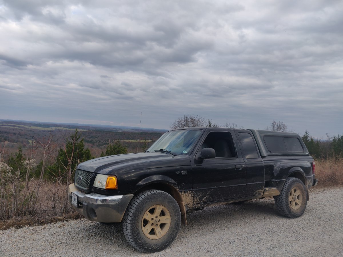

Think my problem is either solved or temporarily solved, driven about 350 miles now with motor running good and no smoke, even took it wheeling and camping this weekend, thanks all that commented for the diagnosing tips
