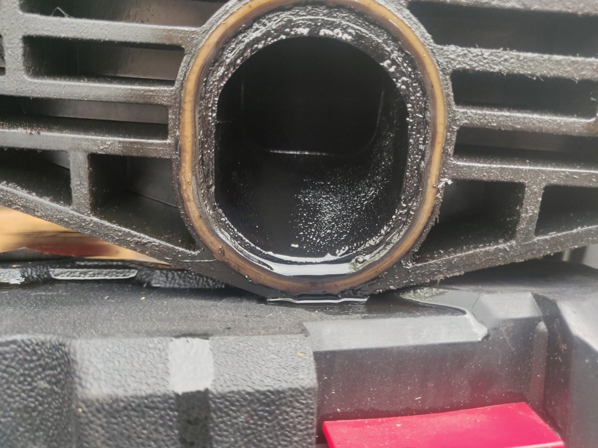

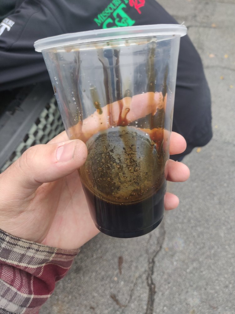

Finally got around to pulling some parts off my truck as it has been raining alot and I only have my apartment parking lot to work at school, what I found before getting stopped by rain again was a literal pond of oil inside my intake manifold, I pumped out about 4-5oz of oil with more oil still in there. I'm assuming this is a sign of a severely failed pcv valve. Any other opinions on why the oil is collecting at such a incredible rate? Here's a pic of the oil I pumped out
That most likely is build up over time from a failed pcv valve. Change it and see how it does. If you keep getting oil in the intake then you most likely have blow by from ring issues. To test blow bly let the engine idle with the oil fill cap off. Lay a sheet of paper over the fill hole and see if any compression is blowing the paper up or if any oil is blowing out. Good engine should no lift the paper and not leave any oil residue.

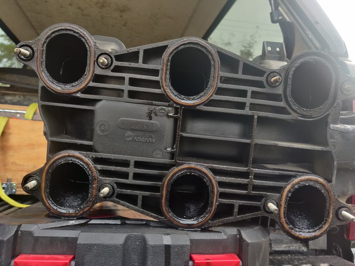

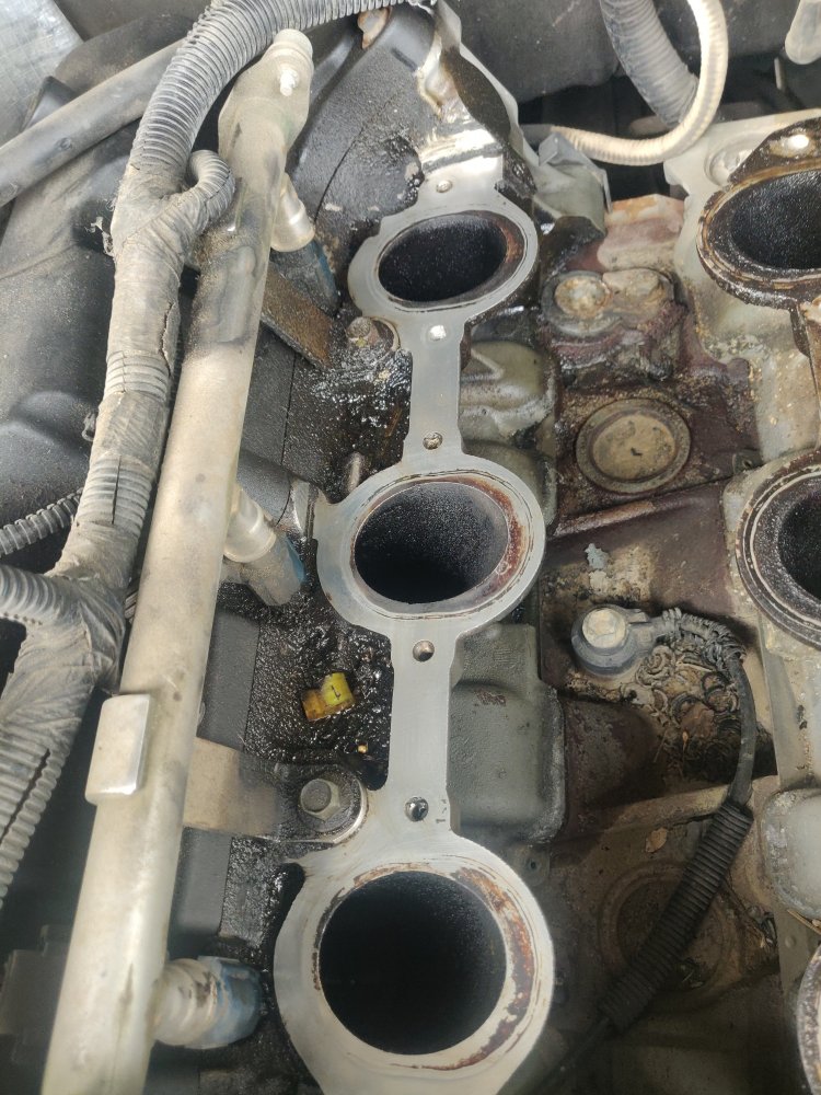

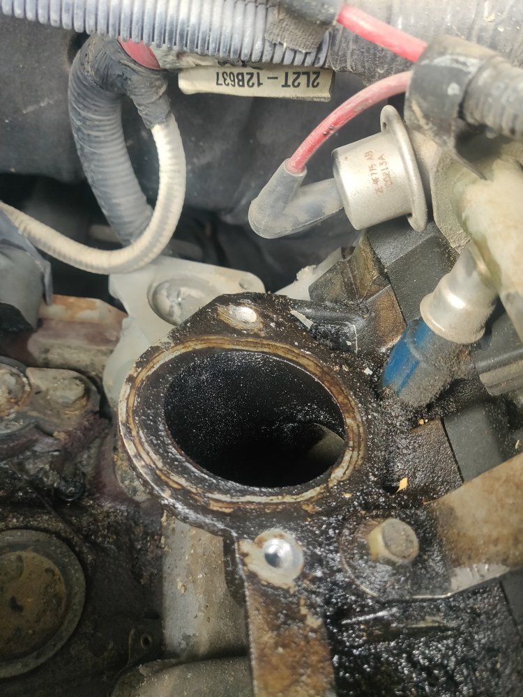

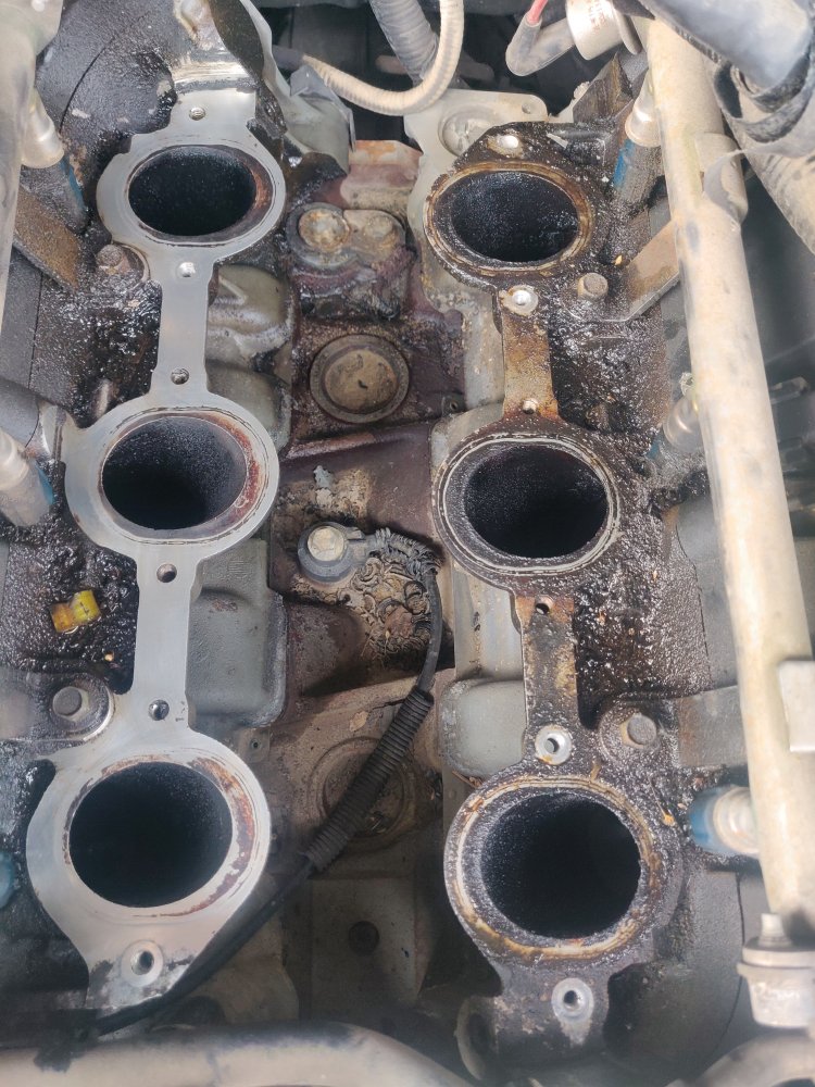

Back again with another update, took the intake manifold off and I have some pictures to go with that, my intake manifold gaskets do appear to be shot based on the amount of oil in my valley. I attempted to change my pcv about a month ago and learned the two little tabs for the half turn on the pcv were gone, so I used some quick set rtv and put a bead around the edge of my pcv and duct taped it over night to set. I'm hoping my shotty backyard fix is what is causing my problems. I currently have a new driver side valve cover on the way with new gaskets for both sides and a new motorcraft pcv, also got a couple other pcv related parts on the way. Current plan is to change valve cover gasket, get the new valve cover in and new pcv. I'll also throw in some fresh motorcraft spark plugs at the end because my current ones are pretty oily and could be fouled. I'm waiting for my valve cover gaskets at the moment so I can't go any further today as I don't want my truck sitting outside with no valve covers for a few days. Anyone have some opinions on what could be causing this? Bad egr valve? Bad vaccum line somewhere else? I understand blow by is possible but I compression tested every cylinder to be about 180psi. Here's some pics of the amount of oil, passenger side inlets were cleaned before the picture but I didn't touch the driver side.
You can still have good compression and blow by.
Are you saying blow by is most likely my culprit here or I just shouldn't rule it out, I'm for sure going forward with what I'm doing and going to assume that's my problem if I get it back together and the problem persist.
You said you did a compression test not the blow by test I informed you of. Perform the blow by test and you will find out if you do. Simple as that.
Correct, the truck was already partially apart when you suggested that and I'm planning on doing it first thing once it's back together. The way I see it is both my valve cover gaskets are leaking anyways and my intake manifold gaskets are leaking obviously as well, if the ending result is my rings are bad I'll probably sell the truck as is and replace it, don't have the time to do a full engine pull to rebuild it in my current situation with school.
Sounds good. Hell I ran a truck for 6 years with terrible blow by until a man hole jumped up and cracked the oil pan .changed the plus every now and then andit ran fine
