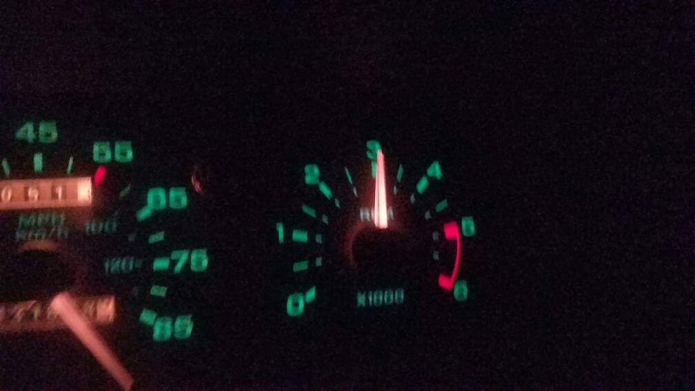

The truck will limit to 4000 rpm in 4th and ~3000 rpm in overdrive (5th) it will shut off the fuel and I'm wondering where that program is and I didn't know that the truck could tell what gear the manual transmission was in as for the speed I'm not quite sure the needle goes past 85 probably past 90 too but the needle stops at the dash it hits it and stops but the speed will still increase and if I'm going down a hill I can get overdrive to go to ~3600 rpm before it kicks in then the fuel shuts off till it gets down to 2700 then I can go back up to 3100 and it will kick in again

I will post a video showing that once the rpm reach these rpm ALL engine power will cutoff and it will be as if I let off the gas completely I am certain that there is not an issue with power

I never assumed that the pcm knew what gear the trans. was in but as you can see in the video it cuts out at exactly 3000rpm in O/D and 4000rpm in 4th. Can the speedometer cable limit the speed because if I am going down a hill I can get it to 3000 in O/D and 4400 in 4th the truck will accelerate then suddenly loose all power as if I turned the ignition to the office pos. with it in gear but all the lights stayed on because the engine is turning and the ignition is in the run pos. if I'm going down a hill it will lag to cut off [fuel I believe but maybe air] I would just like to get rid of this to see how fast I can honestly at 4750 rpm in O/D

115mph on flat ground is probably all you're going to get. I don't mean to sound like a party pooper, but I don't think that it would be worth the effort to defeat the limiter for a vehicle that can't achieve Autobahn speeds, let alone accurately display any velocity above 85mph.
I run a 1993 4.0 engine and PCM in my personal truck and I can assure you that it will do more than 115mph on flat ground.
I have a Gen1 truck with the 140mph motorsport speedometer and I've had it to 125-ish several times, I say "-ish" because at that speed in the wind conditions I didn't take the time to "Study" the speedo.
I'm sure the truck would go faster than 125mph because each time I have attempted a speed run I've managed to lose a balance weight off a front wheel which caused me to abort the run at just over 125.
When this truck was built it had a 2.9 in it and I know I could get into the factory speed limiter (112mph) with that engine and a slight tailwind... and the 4.0 though not as revvy, is a much better torque producer across the entire rpm range...
