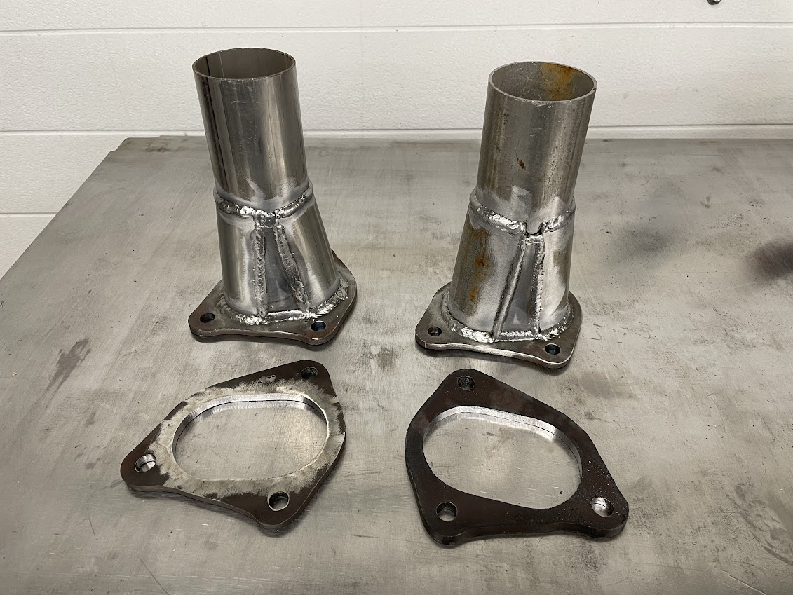

I am building these as a side project to hopefully make doing your own custom exhaust a little easier - or maybe your catalytic converter was stolen and you are having some sticker shock at the price of a new one... whatever the case is, using an aftermarket catalytic converter is usually substantially cheaper than a full OEM assembly. This part will convert your factory Y pipe into a single 2.5" round outlet without modifying it at all. Simply unbolt your existing catalytic converter, bolt my part on with a new gasket & new bolts, and clamp or weld new pipe after that. Here are a few details you need to know:
  • This is NOT a cat delete device; it is a violation of federal law to use it as such. Don't do it.
  • Fits 1990-? 4.0 Rangers & Explorers, possibly some late 80's-'92 trucks with 2.9 V6 engines
  • Does NOT fit any other application and I do not have a part to fit those at this time.
  • Assembly is approximately 8" long w/ 4" of straight 2.5" tubing at the outlet
  • Flange is 1/4" mild steel, CNC plasma cut to the shape of your flange
  • You will need to cut a section off of the inner Y pipe to accommodate the squeeze into one pipe - see second picture. Leave approximately 1/2" to 1"
  • Be sure that this is what you need, there will be no returns.
  • Price for a complete conversion piece is $65 plus shipping and the price for the flat flange ONLY, DIY version is $25+ shipping.
  • These are made to order; I have 3 complete assemblies and 3 flanges on hand as of 1-21-2024
  • Private message me to order.
From here does it use 2.5 inches the rest of the way?
It could if you want, or you could increase it or decrease. 2.5” was the easiest to neck down into because the oval part of the cat flange is 2.5”.
This is basically what you end up with after install (this particular one used the remains of a factory flange.) I built a bunch of them like this to use aftermarket cats when the factory ones were rusted out but it became really hard to find good flanges with usable studs. Y pipes are easy.

I also tried the 3" pipe trick, that is certainly less seams to weld but then you have to reduce it. I'm not sure my way is really better, but it works, basically I take two 4" pieces of 2.5" and cut one in half down the sides, tack that to the flange and then stick the other 4" piece inside those & tack it. Then flatten out a piece and make little pie shapes to fill in the gaps, weld it all together & you're done. It's a lot more seams to weld but it works OK.
