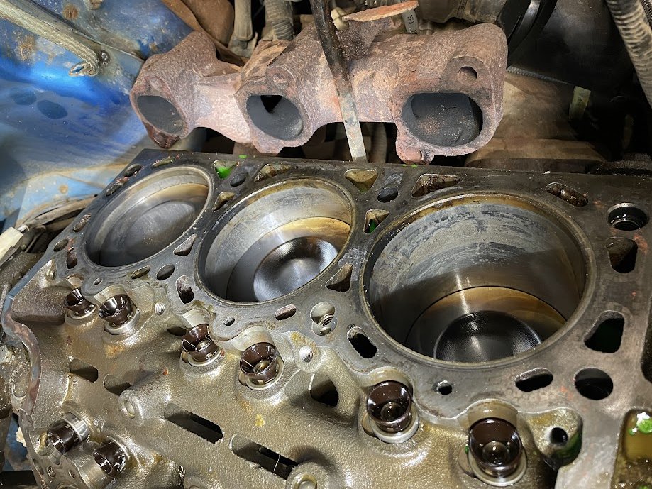

Cylinder walls had a lot of coolant staining in the top couple inches - see below. Otherwise there was a fair bit of crosshatch remaining and no ridge at the top... I was advised not to worry about the stains. The cylinder walls felt nice and smooth so I assumed it was just cosmetic. I will run a compression test - I guess at this point I really suspect it is a ring issue and IF that is the case, I might as well just pull it, have it honed or bored and inspect everything else. I just want to make sure there is nothing else to check before I go to that much effort.

I would be going along the same line. You'll know for sure when you get eyes on the rings and measure the cylinder bore.
If it's just a re-ring and a hone on the original bores, it'd be a no-brainer to me. That's a clean truck, and the '94 is a sweet-spot year. You'll end up with a like-new truck that'll last many a mile and a long time.
