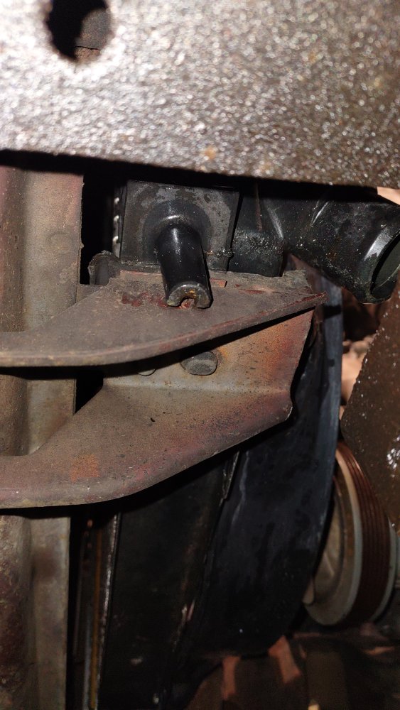

Just a little time to work on the Bronco today after church. I got the radiator from the Explorer mounted in. I'm pretty sure I could've run the radiator from the 2.8L, but it had a crack at the upper hose connection and was leaking a little. The Explorer radiator and fan shroud were in better condition.
To get it to work I had to shave the cylindrical posts on the bottom of the Explorer radiator, as they wouldn't allow the radiator to sit down far enough with the lower mounts from the 2.8L radiator. I considered swapping the lower mounts from the Explorer, but that seemed like an unnecessary amount of work. I took off about 1/4" from each post, and that way they straddled the 2.8L lower mounts. The radiator still fit into the rubber cradles on the 2.8L mounts, so I'm comfortable that it shouldn't move around.
This is the shave job I did.
This is with the radiator mounted, looking up at the bottom on the driver's side.
I was concerned that the radiator cap might sit too high for the hood to close, so as soon as it was all mounted my son helped me lay the hood back in place to see if it would close. What a sigh of relief when I realized it would work!

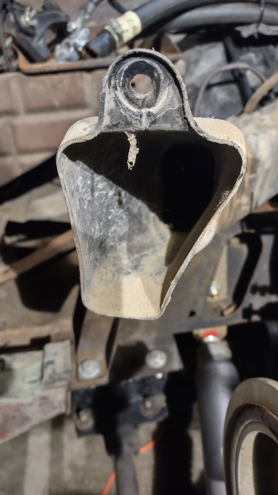

I got the new tank installed today. The old tank was still full of fuel, so I siphoned it out into gas tanks. While I was shuffling the old tank around I discovered a pinhole in the bottom, so the new tank was timely. Mud on the exterior of the tank was keeping it sealed.
I may add some old bike tire tube bits before the skid plate is installed, as it looks like rubbing on the skid plate is what wore the hole in the tank.
