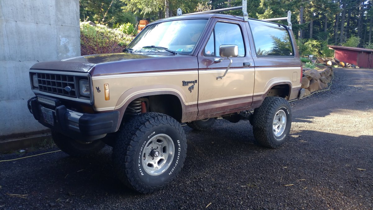

I got started on the engine swap this weekend and figured I'd start a thread on it. First, a little history...
We've owned this Bronco II for a couple of years now, and it has earned the name "Little Brown Deuce." When we first got it we couldn't drive it faster than 35mph and keep it between the lines. We ended up replacing the suspension system and several steering components, and finally got it to where we could drive it pretty comfortably at 55mph. That is, when it was running.
The previous owner rebuilt the 2.8L, and I have no doubt he did a good job overall, but it's been one problem after another. Even on it's best day, the 2.8L has been really unimpressive in the power category.
More recently, a nut from the air cleaner stem fell into the carb, through the intake, and found it's resting place on the #4 piston. At least, I'm pretty sure that's what happened. Either way, it smoked the intake valve and seat, smashed the piston, sticking the rings. Rather than putting time and money to get back to a running motor I didn't really like in the first place, I figured it was time for an upgrade.

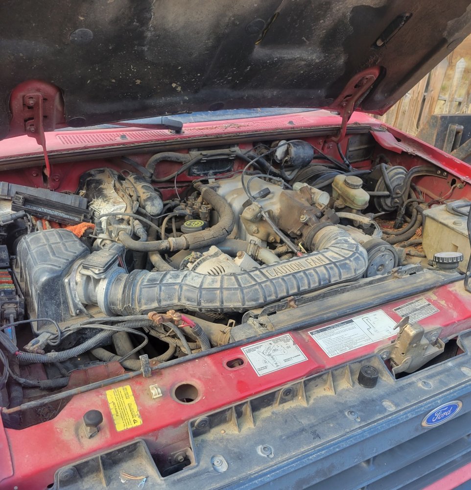

I've seriously considered a 302 swap, but finally decided to pull the trigger on buying a 92 Explorer with the 4.0L. So I plan to swap the motor, the center console, maybe front seats, and eventually the axles.
The donor is a 1992 Explorer 2 door. Motor is good, auto transmission is bad. Overall seems to be a pretty sound vehicle.
The recipient is a 1984 Bronco II, which is currently waiting for a heart transplant to mount back up to the 5 spd manual transmission. We installed a 4" lift, sat it on 32" BFG's, and regeared to 4.56 gears.

This weekend I started stripping the wiring and accessories from the 4.0, labeling all the wires as I disconnected them. I've been going slow and trying to enjoy the process, and taken pictures along the way to help when my memory fails.

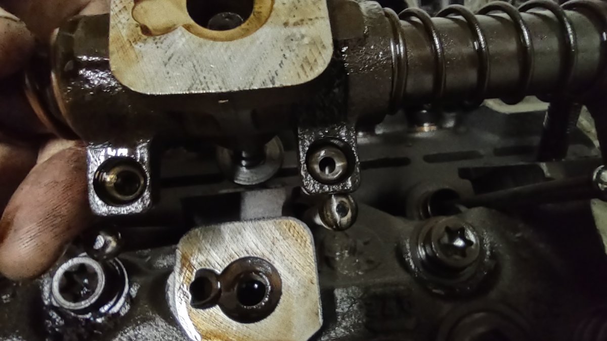

Not a lot accomplished this evening, but I did pull the valve covers, intake manifold, and rocker assembly. I wanted to get a look into the motor, and also inspect the pushrods. I think I'm the first one to open this motor up, and everything is looking pretty good (to my mostly untrained eye). However, one pushrod has me wondering. Of the 12 of them, 11 look identical in terms of wear. One of them, however, has worn differently on the rocker end. You can see the difference on both the rocker and the pushrod in the attached photo. The right is a smaller dark spot than the left one, and the left one is typical of the other 11. Is this from poor oiling on this one, or from this one receiving better oiling? What's the remedy? Blow compressed air through the oil passages? The pushrod in question is the #5 exhaust. And, at what point do the pushrods need to be replaced? And do pushrods necessitate new lifters and rockers? I'm wanting to spend my pennies wisely on this project.
4.0 into 84 Bronco II
Spoke to a friend about my pushrod question, and he said it wasn't anything to be alarmed about. I'll check the oil passages in the rocker assembly before buttoning it all back up.
