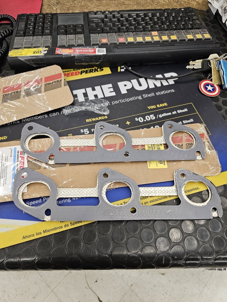

Hi there, been struggling to find a set of 2.9L headers for my 88' Ranger 2.9l '5 Speed 4WD.
I recently compared 4.0 header gaskets with 2.9s and they had the same bolt pattern and lined up perfect. Only difference was that the 4.0s had bigger holes.
Will 4.0 headers work on a 2.9?

I can now never question the benefit from adding a quality set of headers. I have not measured the I.D. of the 98+ OHV 4.0l header tubes but visually there I do not see a difference. The outlet exhaust port of both the 98+ OHV 4.0l and the 2.9l heads are nearly the same, if not the same volume; it only stands to reason that the aftermarket headers for each, will be the same volume, if not extremely close. The pictured exhaust gaskets certainly demonstrate how close the 2 systems are.

Good sir, I am simply sharing a not wildly know n fact; I have a set of JBA 2.9l headers on my 94, 4.0l rebuild, which is using 98+ OHV 4.0l heads. The reason that I used the 2.9l headers on this 4.0l is because the 98+ spec OHV 4.0l heads use the same size exhaust port size, spacing and bolt pattern.
Both the "H" and "Y" pipe variants use a ball-knuckle connection to the headers, which already permits flexibility for the installation angles. I can not say that they will fit using the new manual transmission (05MD).
I'm no rocket scientist, I just had a set of OHV 4.0l heads without headers, I noticed the similarly, checked it out and they fit.
NOTE:
2.9l headers will not work on an OHV 4.0l head from 1991-1997, only on the 98+ spec heads with the reduced size exhaust ports.
