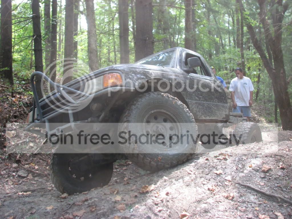

I've been using this crossmember for a long time as a front tow point. Last weekend I got yanked a bit hard and it damn near ripped the crossmember off.
I haven't even taken it completely off to see what I've got to work with yet, but I thought I'd post up to see what other guys have done when they replaced this crossmember; mounting styles, bolt vs weld, etc.
Steering cross member?
Yeah. The one right in front of the pitman arm that protects your steering. Didn't know what else to call it.
Edit: A picture says a thousand words. This one (not my truck):
A bolt is harder to break than a weld. do bolth and use grade 8 bolts or metric 10.8 and you will be good.
Ah that deal...pitman arm/steering box guard thingy. Most rangers don't even have them, but if you want it I'd just use from 1/2" grade 8 bolts and lock nuts.
i cut mine off and made the bumper for protection...
always hated those things, i should have made my bar a little lower. as i built the bumper with stock steering on and now was a drop arm on it
Get rid of it and put a front receiver hitch up there. Then you have something to pull from.
Perhaps it's time to use that fancy bender you have Bray....
Kill two birds with one stone, build a bumper and remedy that crossmember problem...
