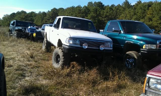

well i went from 33s to 35s to now sas and 37s. its still under the knife but ill post progress as it comes heres some pics.
here it is on 33s
and on 35s
and now under the knife for a eb d44 and a set of 37 iroks?
ill keep you posted on updates and build pics :icon_welder:
