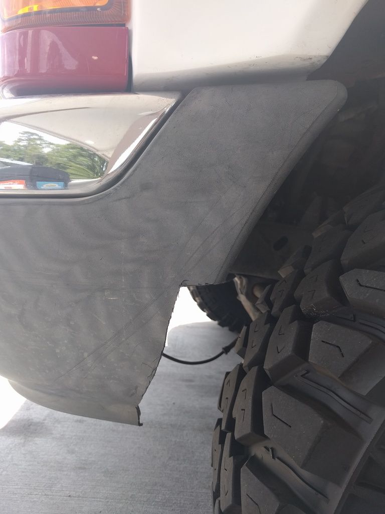

Hello,
I have did this install using 3 inch bulge fiberglass fenders and 1.5 inch wheel spacer on the front. They fit with no trimming on the rear. The wheels are pro comp 15x8 with 3.75 inches of backspacing. I used mickey thompson deegan 38 mud terrains. Had to trim the front bumper a little but with the fenders they fit great.
Pictures of install:
Where I trimmed:
