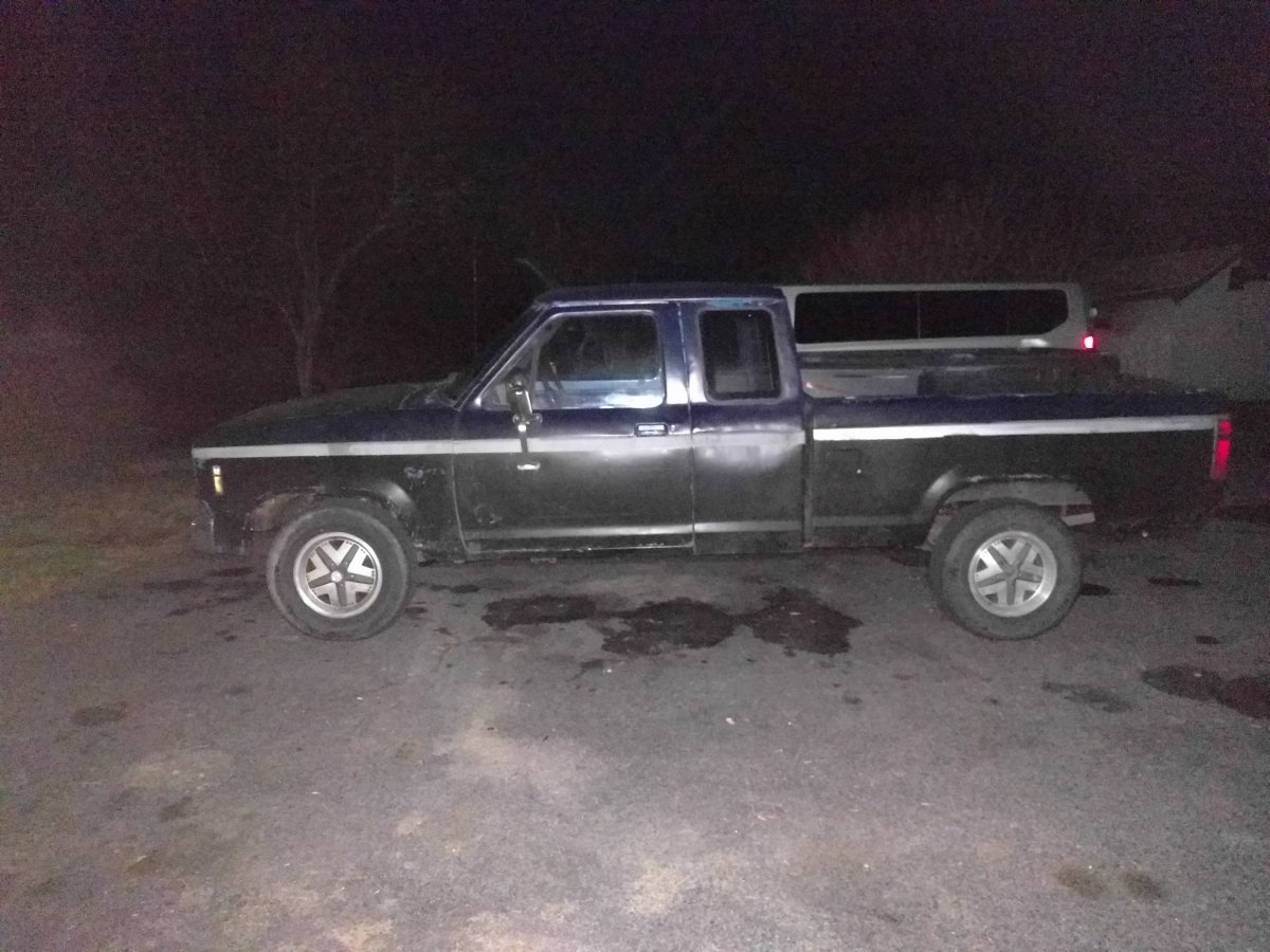

Tires have been on for a few weeks, I did trim the fenders just a hair at the corners but I think it wouldn't have been needed if it weren't for the amount of lean this truck has (with me sitting in it it's just stupid looking). It drives *great* compared to the old tires, it snowed right after I installed them and driving to work in that was amazingly non-sketchy. Also it did help correct my gearing issues a bit. Here are some pics:
Before:
53322
After:
53323
Yeah, mounting tires in that was real fun...
They do rub just a hair going over bumps if I have someone in the passenger seat, I got some new coil springs though and hopefully that helps. I'll get some more pics then.
Fenders trimmed at front or rear corners? Certainly does look much better.
