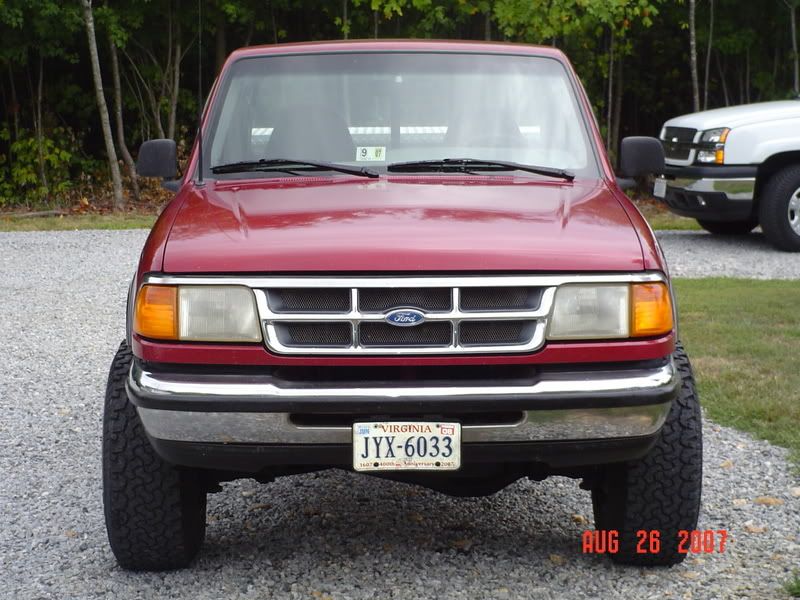

Here's a photo of my mistake with the wide wheel. Great stance but ugly bulging tires.:nono:

ohhh i understand now. in that picture do you have any wheel spacers on it? how did you get your tires to stick out past your bumper like that?
the tires sticking out is a side effect of a 10" wide rim and the offset to put them under a stock ranger, i have run 31's on a 10" 8" and 7" wide wheels, all work, but i usually like to keep my rule of thumb about 3' narrower on the rim will give u the ability to airdown offroad and maintain a proper bead
No spacers. just the 10" wheel. but if you want that stance i'd say either
