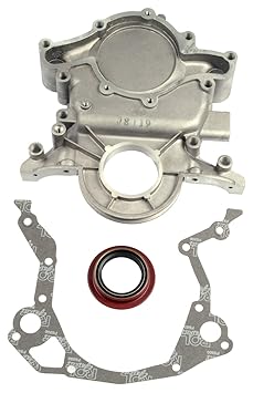

Here is an 85 5.0 Mustang timing cover

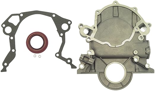

Explorer 5.0 timing cover

See the difference?
And, while MAYBE your setup works well for you. It won't work for me. I'm not going to take my perfectly good alternator/power steering pump, harmonic balancer, timing cover, belt, pulleys, and wiring to throw away so I can an 85 Mustang timing cover and accessories just to use a mechanic fuel pump.
