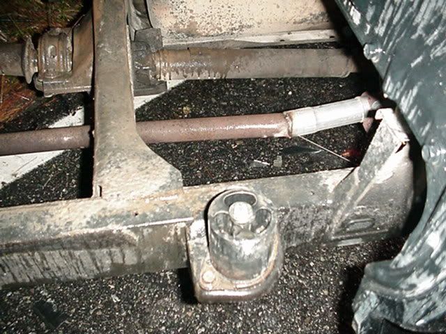

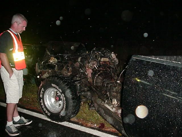

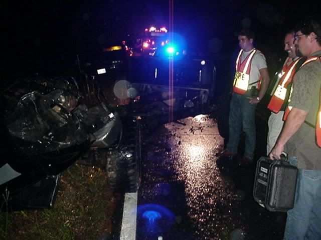

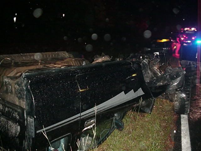

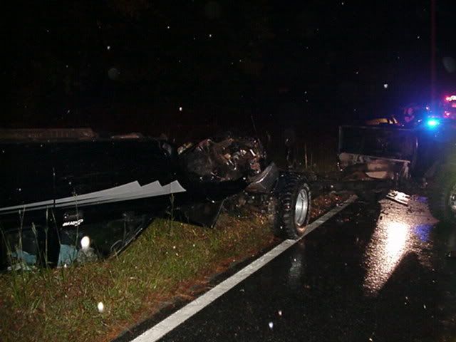

Go 3" max and cut your fenders to clear the biger tires. Put suspension lift on it later. You will have to do way to many modifications for a 6" body lift. Think about what it would do to your steering and shifter geometry. Think about how the body would react if you had an accident, it would roll right off the frame! LOL! Make sure you use quality fasteners or grade 8 bolts or this could happen.....
Kid used to small of washers on the top side of the bolts and they pulled through the body when he hit a ditch.

Ive seen a couple of cabs detach from frames & that why I have always used 1/4" plate cut & drill to work as a top washer for any vehicle I have had body lift kits on.
Bet that was a hell of a ride, I wouldn't even see the point in puttiing that big of a body lift on a toyota they can fit pretty good size tires without any lift. I'm with everyone else of course 3" is plonty, make sure you lift the bumpers too.
