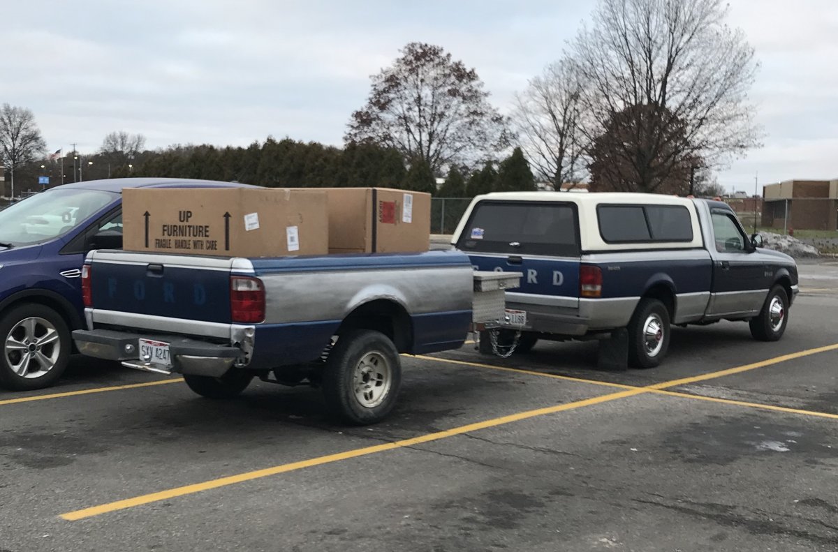

Ive towed a V6 automatic 2wd ranger longbed with a 2.3 ranger before on a tow dolly, I dont recommend it but Ive done it. I have a box trailer, a 7x10 flatbed and a ranger longbed trailer. I dont tow much with the ranger anymore now that we have a escape, but at one time it was either the ranger or a hhr and I wasn’t putting a hitch on the hhr. Sometimes you just have to use what you have, I may get a mid-90’s 1/2 ton someday just for trailering, the bigger brakes alone would be worth it.
I would not recommend doing this but...

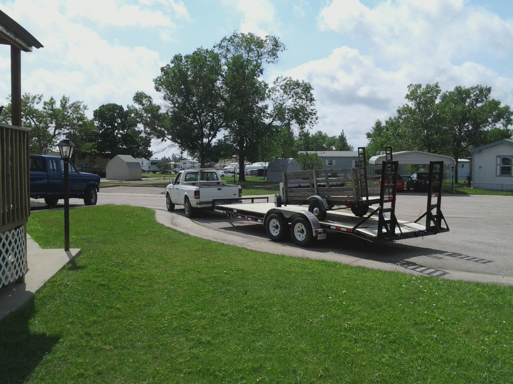

Haha, I think the car trailer weighs somewhere around 2500lbs... the little trailer on top is like 300, maybe not even that.
I used my little 4 cylinder Ranger in the picture to pull the big trailer around the block a few times. I couldn't park trailers at my house when I lived there. It was totally doable, but I really had to ride the clutch to get it moving and always smelled clutch afterwards so I quit doing it. That picture was more or less just a poser shot that I thought would be funny for Facebook.
Actually I towed that car trailer with my V8 Ranger a few times. Other than horrible ride quality and needing an obscene 20" drop hitch to compensate for the lift, it was alright.
