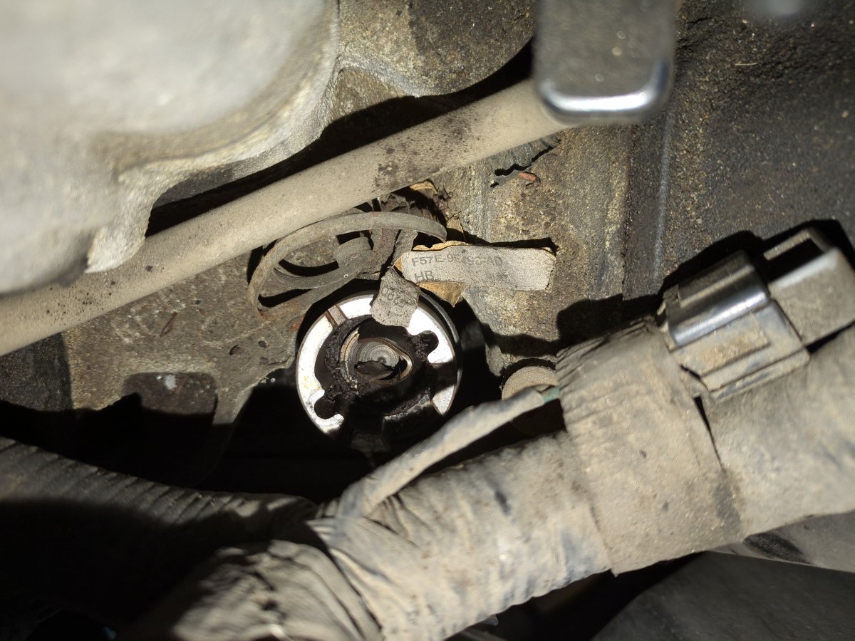

Also, the moon shaped part of the synchro that spins is rather mangled. Any reason why that would be? See picture. I took this photo before attempting to remove it so I could mark the position of the moon part.

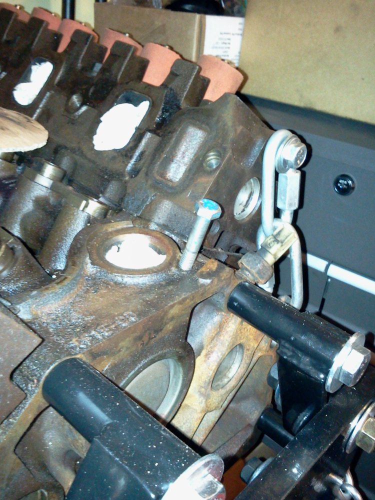

this is what you need to do, remove the housing.
the bolt hole is crooked from the factory. it contacts the clamp better that way.
the innerds will come out with the housing.
ignore the custom low tension valve springs. :icon_rofl:

Yeah, that's my assumption. I have been hitting it with penetrant and a hammer every 30 minutes today but it wont budge. I gave up on trying to mark how it was position before i messed with it, given the state of the indicator on top (see my photo) I think the last owner also tried this.
