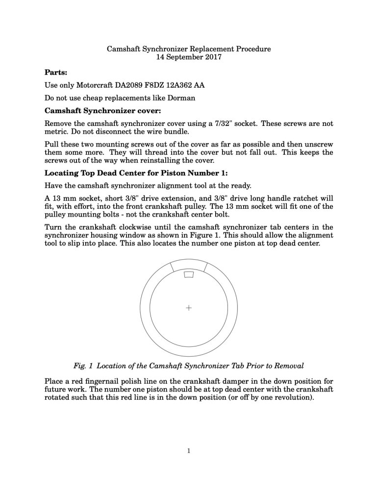

OK, from the 2005 factory manual, page 303-14-4
"rotate the crankshaft until the No.1 cylinder is at TDC of the compression stroke and the TDC mark lines up with the timing mark"
set it at the pyramid and see if the screwdriver hits the piston top.

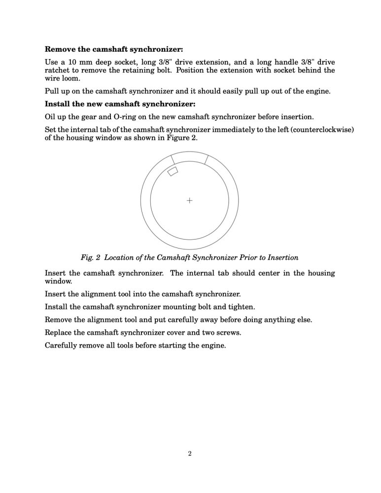

I found the little pyramid thing that is to the right of the crank sensor. I lined that up with the first tooth after 0 TDC per the install instructions. New one went in with some wiggling, but otherwise not much trouble. She had been sitting for a bit so she needed a jump. Other than that fired right up. I guess battery was low enough to clear codes since none are there now. Any sensor data I can monitor to confirm the fix?
