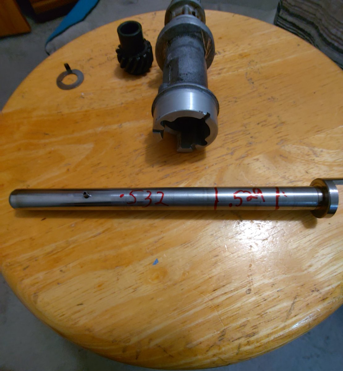

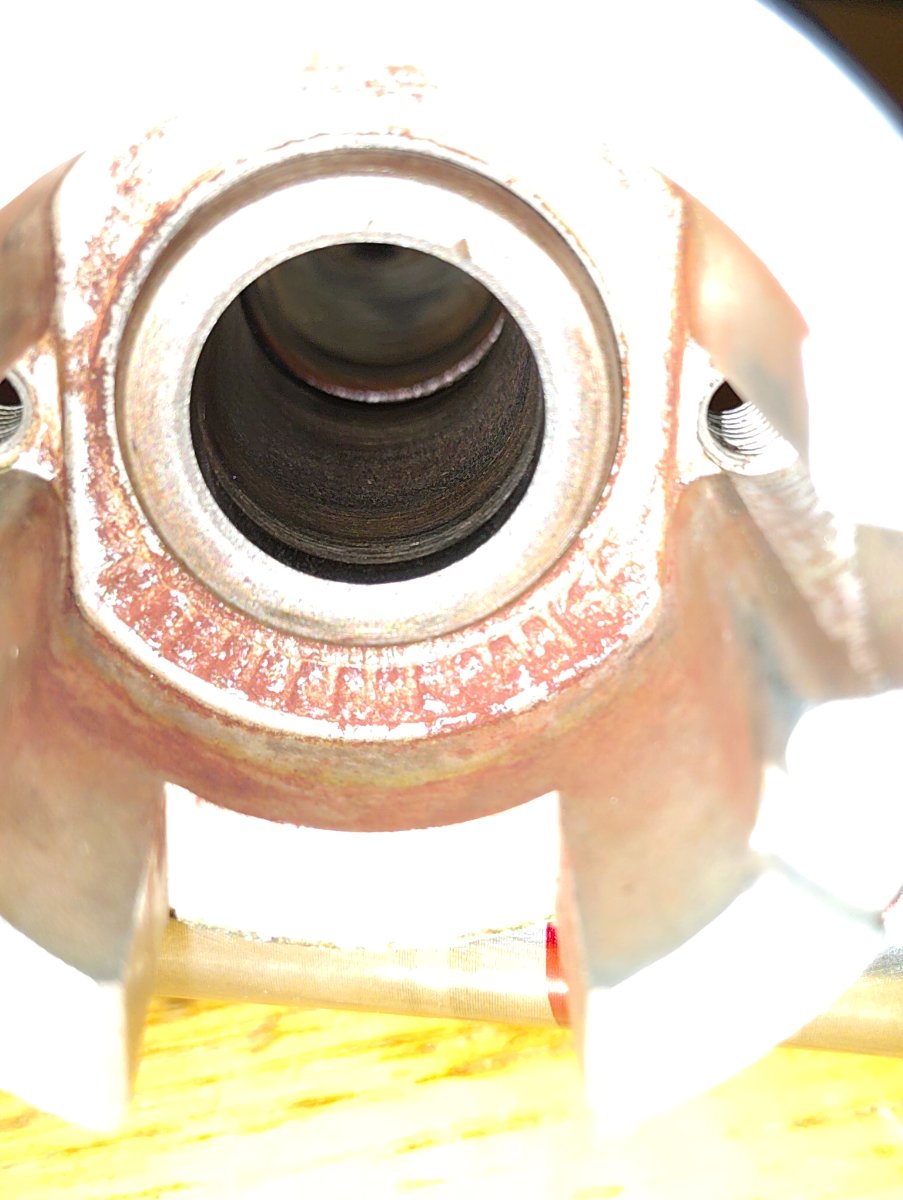

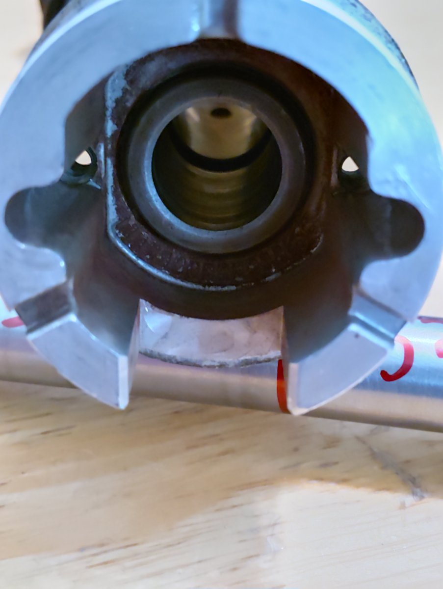

I'm guessing the one I just removed from one engine and put in another has 230,000 miles on it and I didnt see any signs of wear. Thats why i'm thinking it's not a part problem but an oil flow problem. Is there certain years that are locking up? Has anyone who changes their oil ever 3000 had one go bad? How can an oiled bushing rust? Either there is water in the oil or there is lack of oil (possibly a restriction), or the part has an oil distribution problem.
