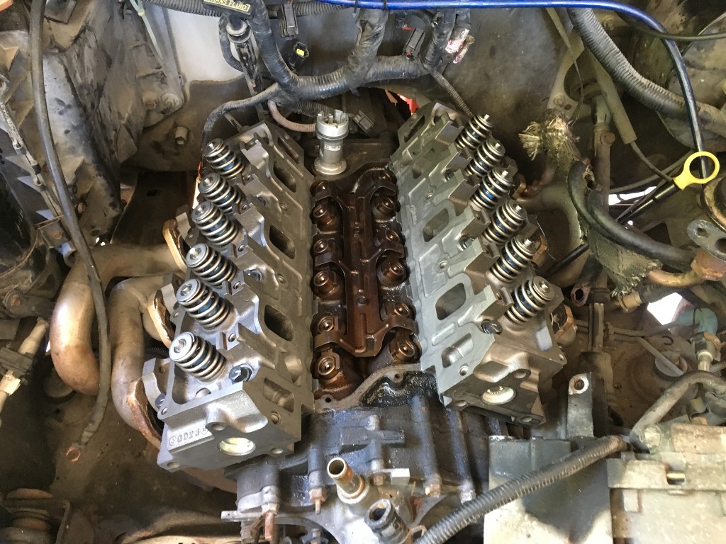

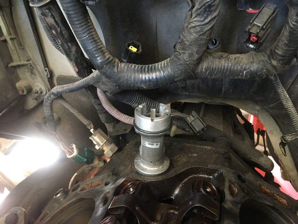

Swapped heads on my 2000 3.0 Here is a pic of the engine at top dead center and how the synchronizer should look installed correctly:
3.0L Camshaft Position Sensor & Syncronizer
