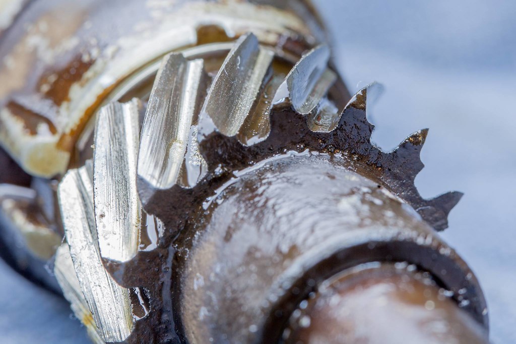

My 99 made it to 229K before the gear stripped and the motor locked up..
worn synchronizer gear
