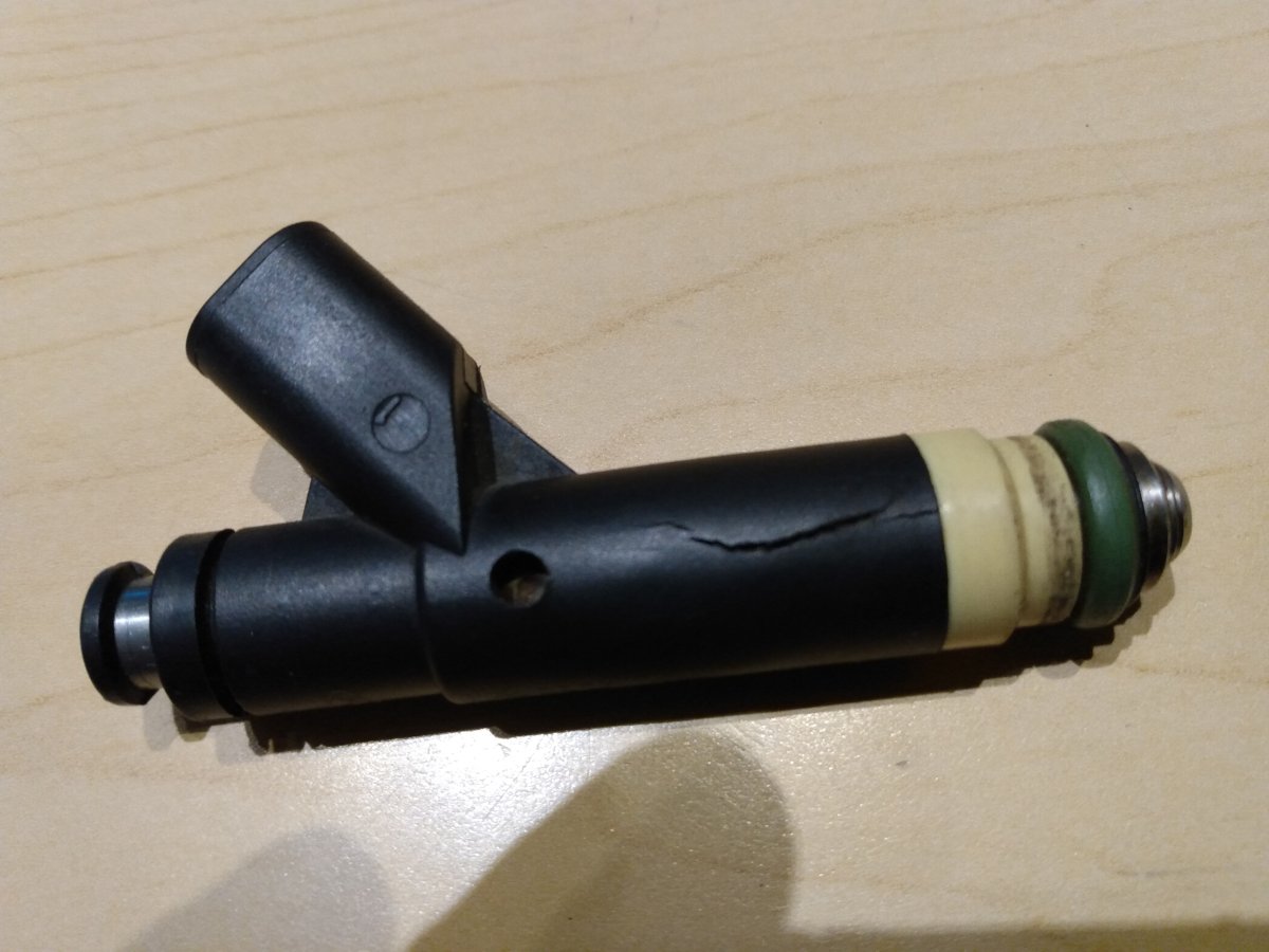

Ok...gang...been working with the theory it's fuel related and need to look at the injectors on bank 2.
Learned I could 'rebuild' injectors with kit. (replace o rings and filter basket.
Tore into today and this is a pic of the first injector I pulled. (from the affected Bank 2) Crack in body. Looks like it's been there a while.
Anyone seen this before. Swollen in that area as well...Could this cause a air leak? Malfunction in injector?
My new plan is to go to Pull a Part, get an OEM replacement and rebuild that.
Any one experinced this before?
Ok...Gang...thought I would close the loop here..and hope to help someone else.
My problem is solved and Ranger is running like a top now.
Turns out, problem was not fuel related.
It was ignition related. It was the coil pack. Truck runs like a beast now.
Lots os elbow grease, a little cash and a few trips to Pull a Part. All is good now!
