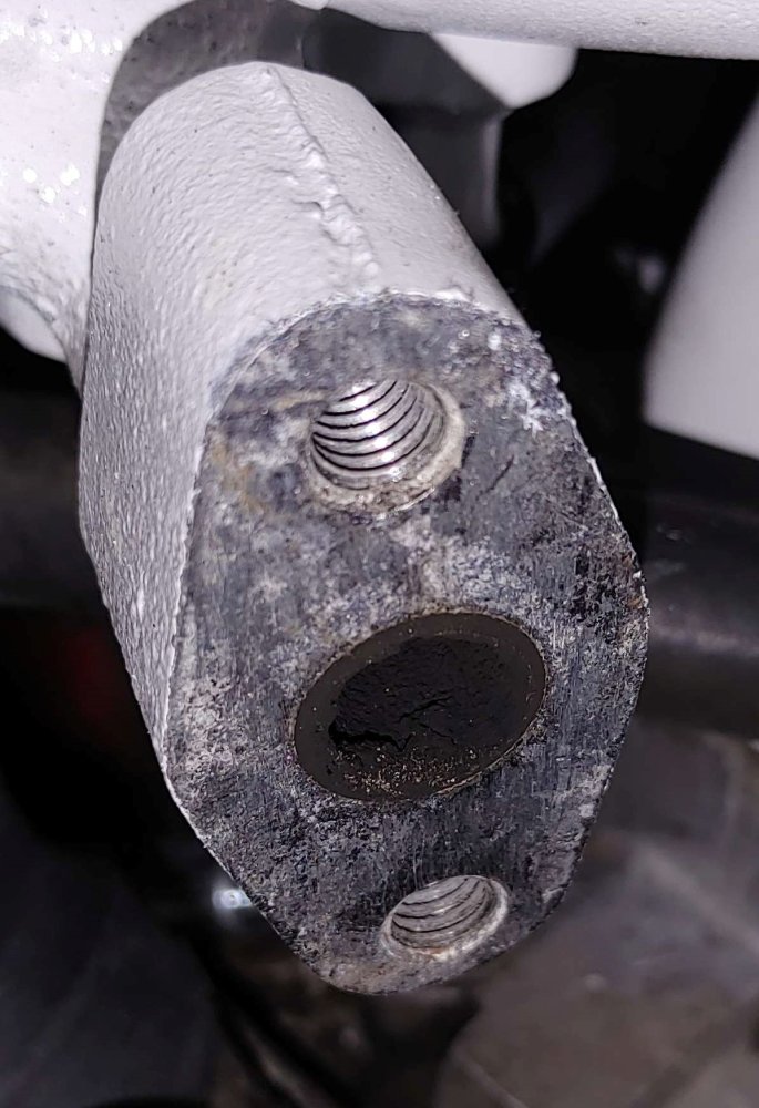

How did the EGR port look inside the plenium? I had EGR codes after replacing everything too and the port was completly blocked by rock hard carbon. I had to chisel it out with a bolt
Yeah the little black box on the plenium by the EGR.
Sorry for taking so long to reply. I didn't have much time to do anything with the truck. I finally put in the new rotor and plug wires and it changed nothing. The EGR port has a small lining of carbon about 1/16" thick. Does that seem like a big problem...? The truck was running stupid rich not too long ago (still runs a bit rich now but not nearly as bad) so not sure if maybe all that gunked up the EGR. I forgot to mention in the original post, but it surges at startup for a good 30 seconds then stops surging. It didn't surge like this with the amazon injectors.
Thats not nearly as bad as mine was but id clean it and clean the egr while youre at it
