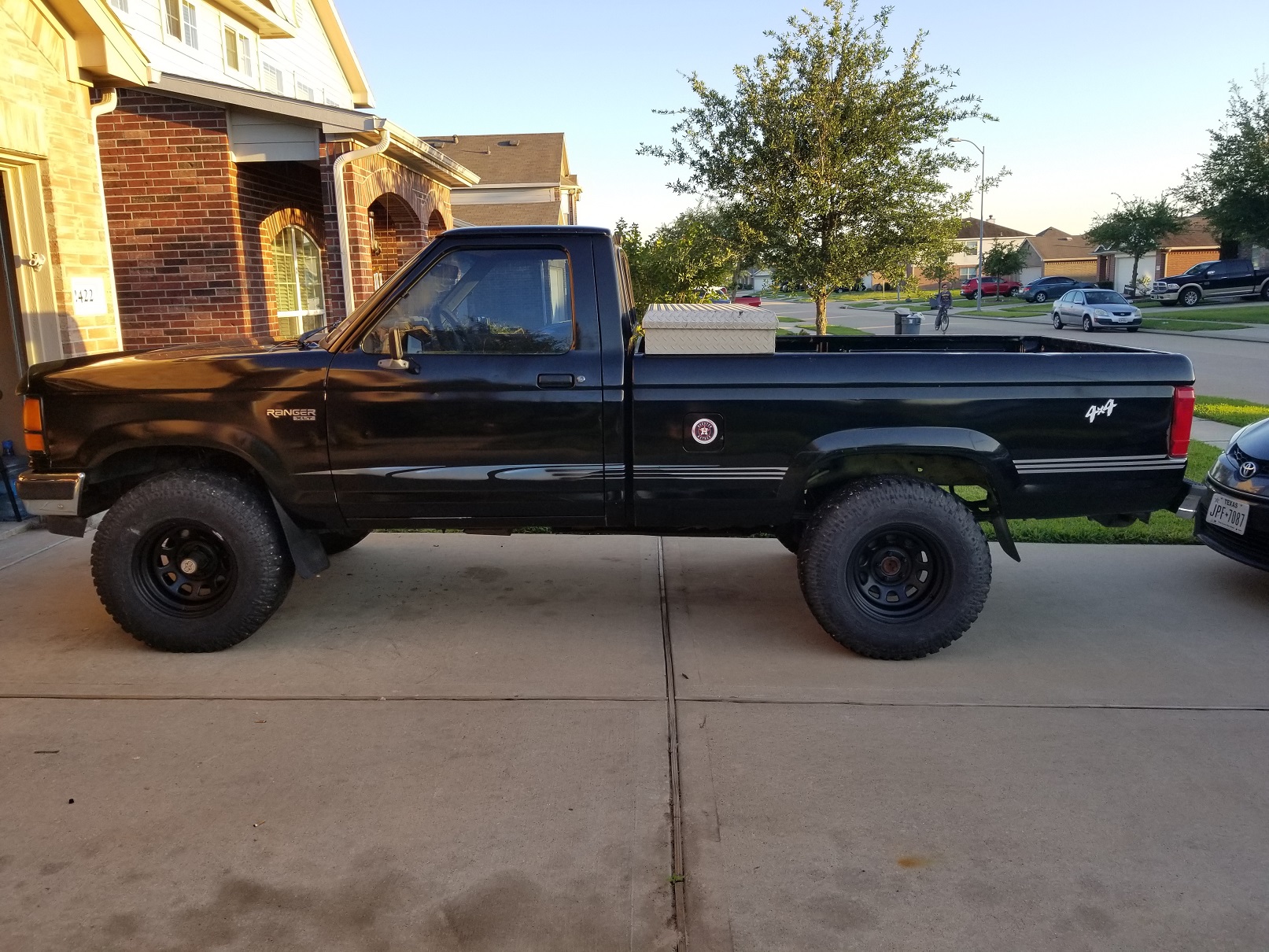

Pic of results. 2" skyjacker coils, belltech 6400 shackles, new shocks, and 31x10.50 mounted on 15x8 with 3.75" B.S.

Hey, nice ride. It’s got me thinking about bead blasting/painting my ’92 and giving her 2” of lift as well. I don’t go in for anything crazy (she’s a DD), but 31s would be nice!

Do it! it looks so much better. And it still rides really nice with the 2" coil springs and shackles. Though in all honesty, I may drop to 30x9.50r15s when I buy new tires just to give it a little more room to flex.
Yes that's my roommates 2016 corolla behind the truck. its soul suckingly slow, but its a good reliable economy car.
