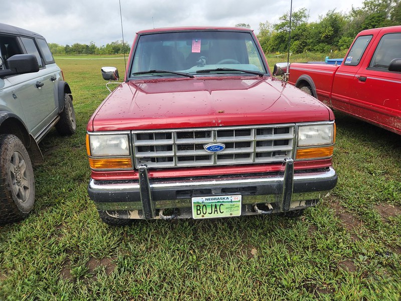

@Poppa_R made a bracket to hold factory loops off a factory truck. They poke thru the fog light holes of a factory air dam. IIRC they are off a newer F-150.
Now that is what I'm talking about!
@Poppa_R would you happen to have any details you could share?

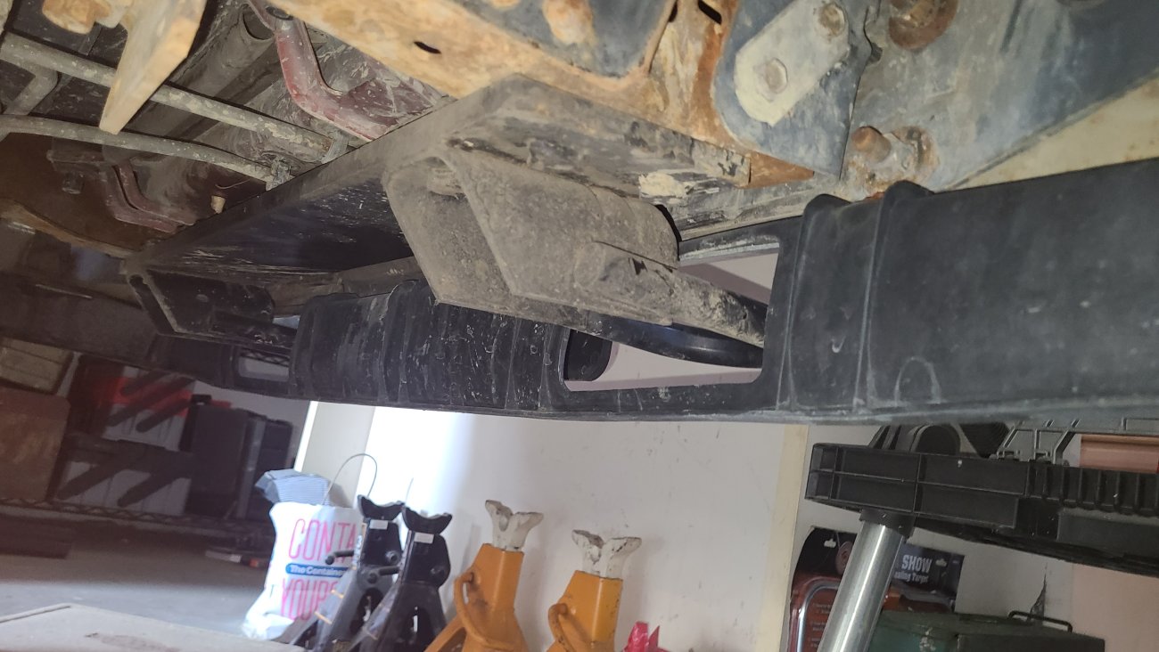

Unfortunately he passed away around noon today, he was my father in law.
We are up at their place now, I did crawl under it and get a picture for you though.
Wow. Is that a piece of 1/2" plate spanning from frame to frame? That makes an awesome mounting surface.
