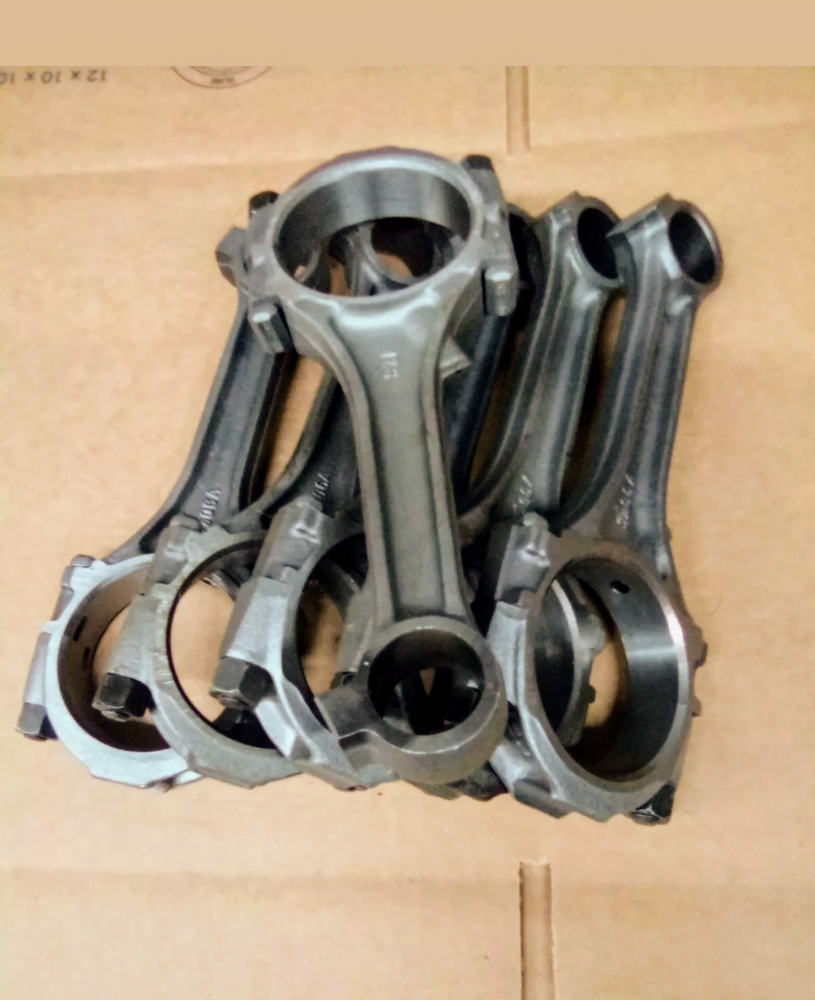

These (see pic) are the goal, they are referred to as the ribbed version (UPDATE; stamped FbOC A). Shaving 240g (well over a ¼ lb) off the rotational weight will also increase efficiency.
I will look into the MLS head gasket, I hadn't heard of them.

Yes, shave the weight and even up the rotating parts. That will absolutely help the efficiency.
