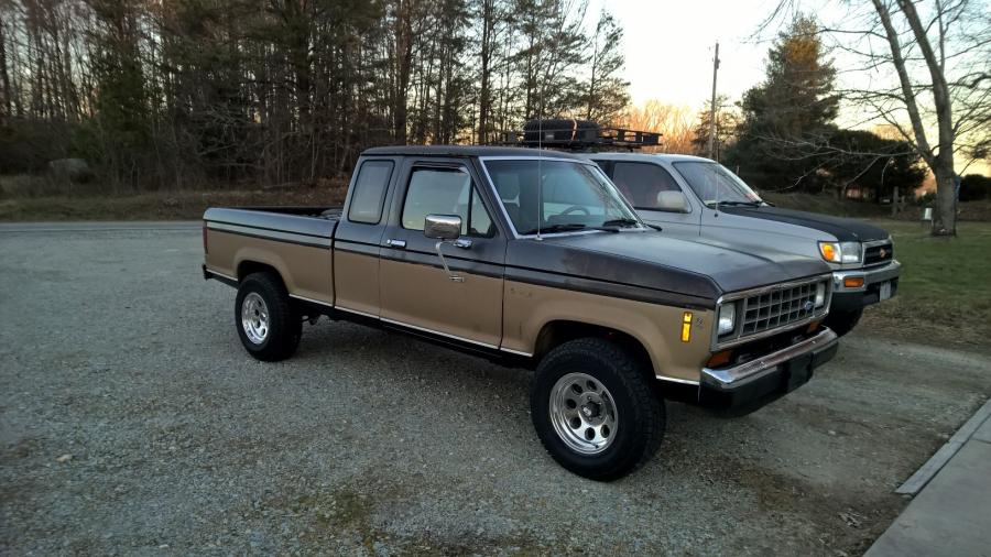

Thanks for all the input guys, anybody happen to have a pic of this setup?
Well, I ended up going with the 235/75 Hankooks and the Level 8 tracker wheels from discount tire. I will post up some pictures when everything is completed. Thanks!
Pics
Finally got the ranger back. New engine, suspension, exhaust, and wheels and tires. Glad to have it back! Here are the pics!!
