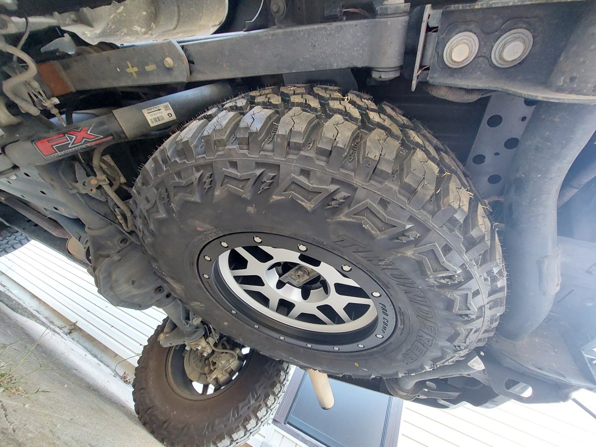

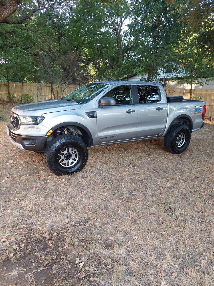

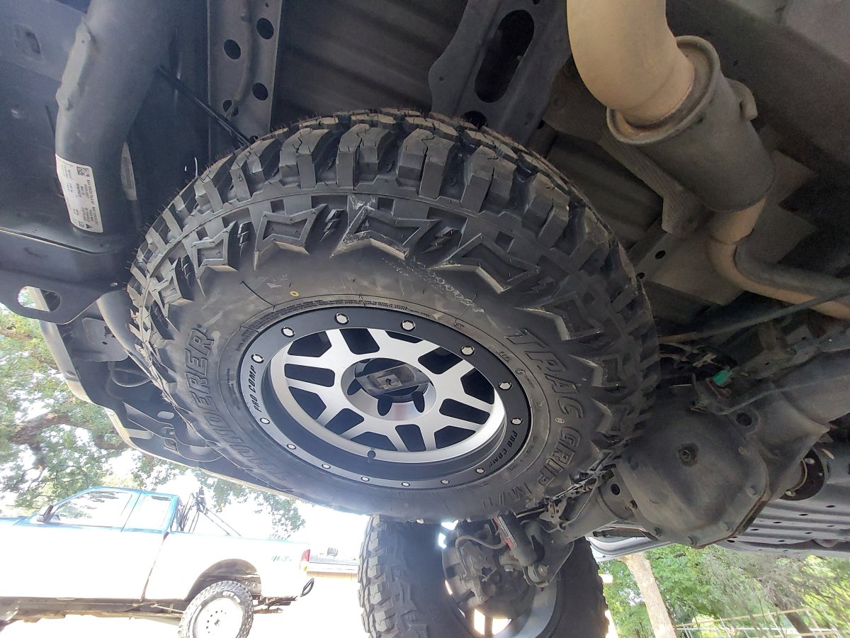

When I got the new wheels and tires I didn't mount the spare under the truck because I wasn't sure if it would fit, and a company had offered me a new bumper to promote that had a swing out tire carrier. After realizing they weren't going to come through for me I decided to mount the spare under the truck.
These new tires measure out to 33.5 inches. It actually fit well with room to spare. I shifted it off to one side a little to keep it away from the exhaust.
It does help that the spare tire rack is an open design on the new Rangers. Just a bar with a couple of rubber contact patches. It will be interesting to see what the limit is. Someone will try a 35 at some point.
I did have to tinker with the tire circumference on Forscan before the speedo read right against my GPS.
Using the tire manufacturer's numbers (Cooper) converted to mm we were in the 2500 range and the speedo was reading much too fast. At 2400 it's spot-on with a 265/70-17 tire.

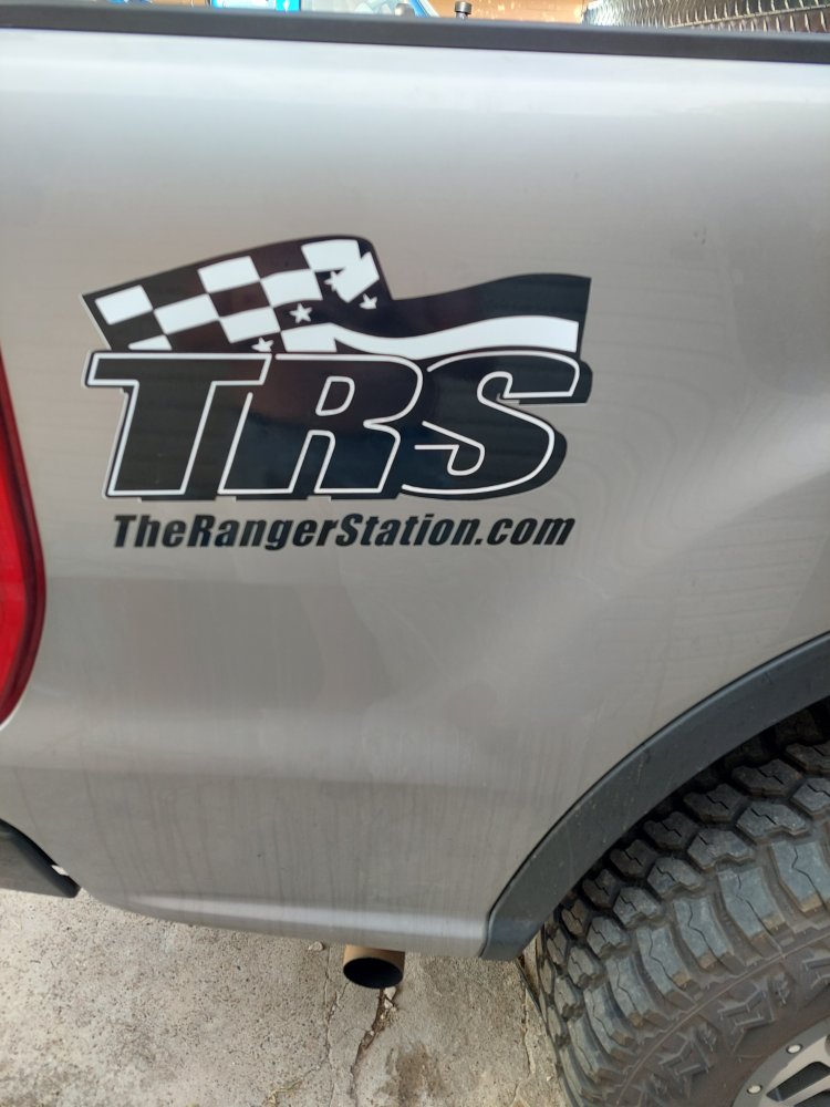

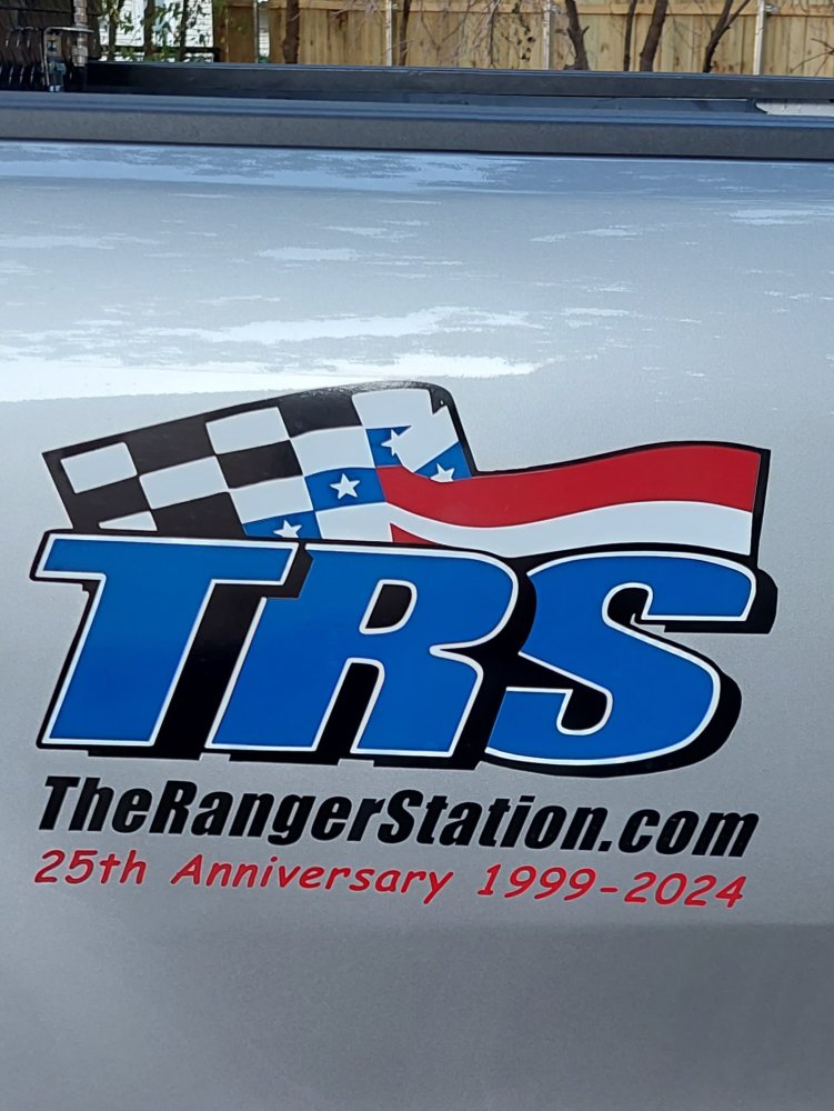

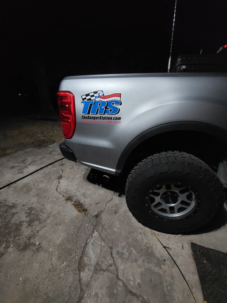

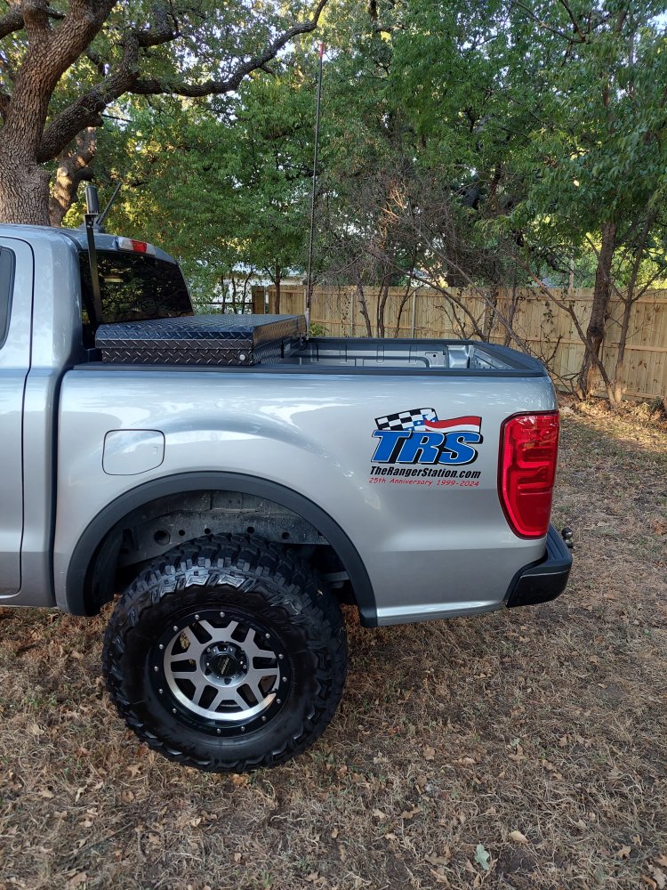

Adding The TRS Logo
I finally removed the FX4 logo and replaced it with a TRS logo.

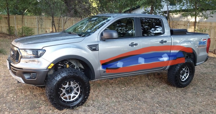

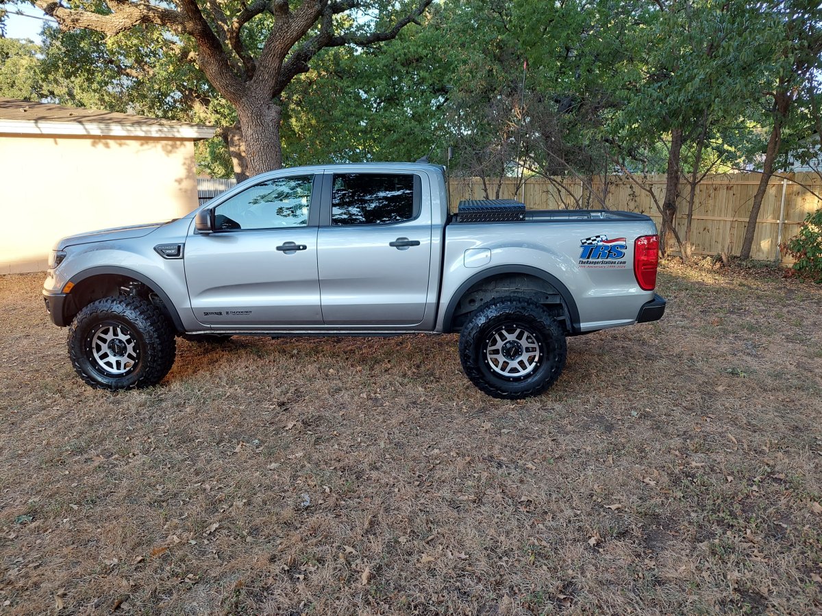

It needs some more red and blue. I thought about adding a red and blue stripe on the front fender that goes up under the hood that follows the angle of the line where the front fender and the plastic panel under the headlight meet.
I also thought about putting a blue stripe up the center of the hood outlined with a red stripe and 3 white stars going up the middle.
Thoughts?

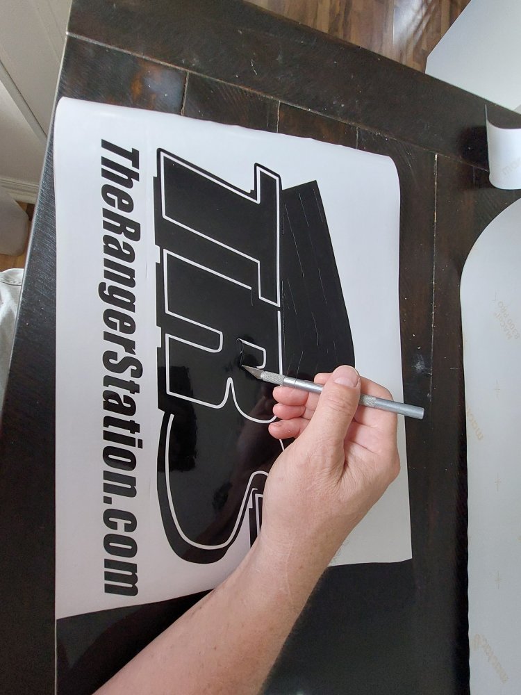

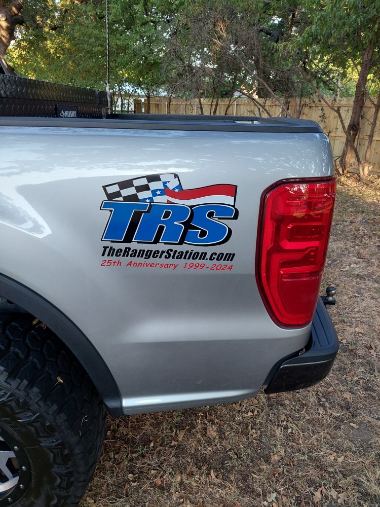

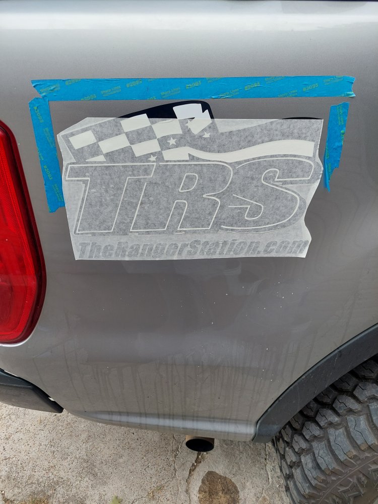

The Making of A TRS Decal:
I layed a line of tape over the tol of the FX4 logo before removing it. Then I marked the edges and a couple of reference points along the bottom to lay it out straight according to how the FX4 logo was laid out.
I do the logo in vinyl because I can make them myself, and because vinyl doesn't fade like printed stickers do.
The logo was made to go over a white bedside, so I laid down a white base for the logo to go on.

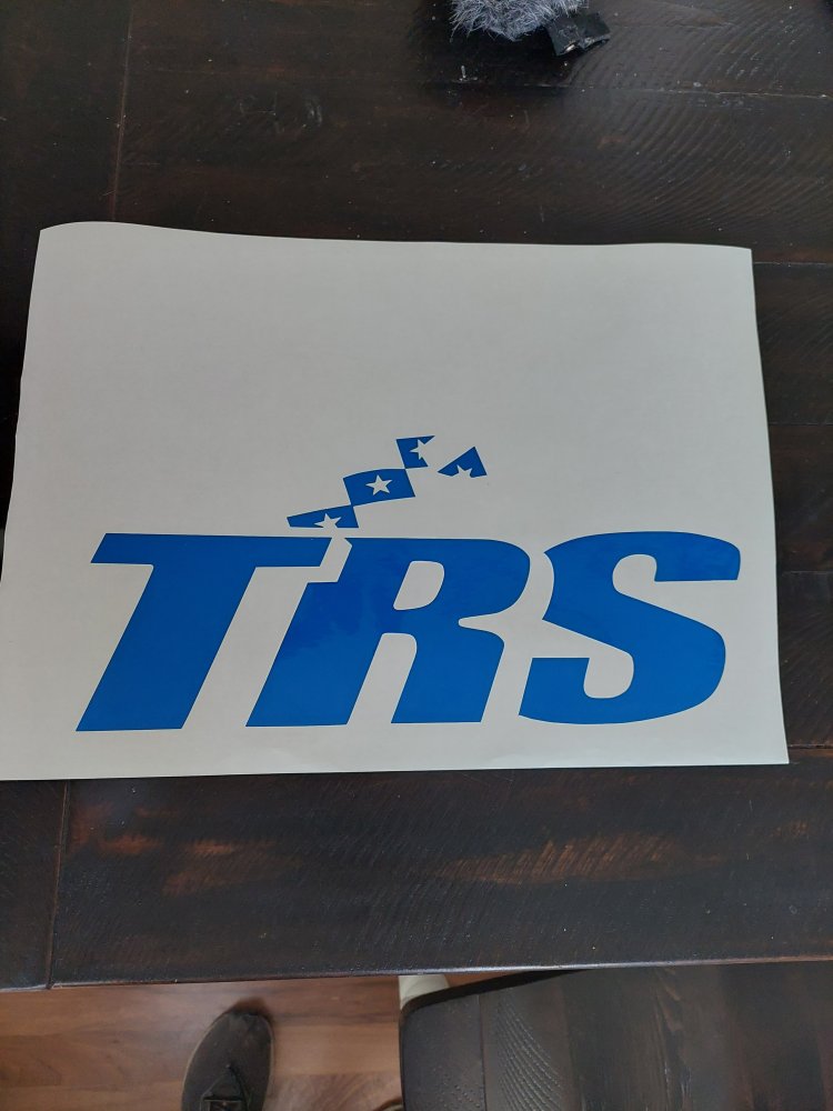

Here's the black vinyl section being 'weeded' before it can get covered with application tape.

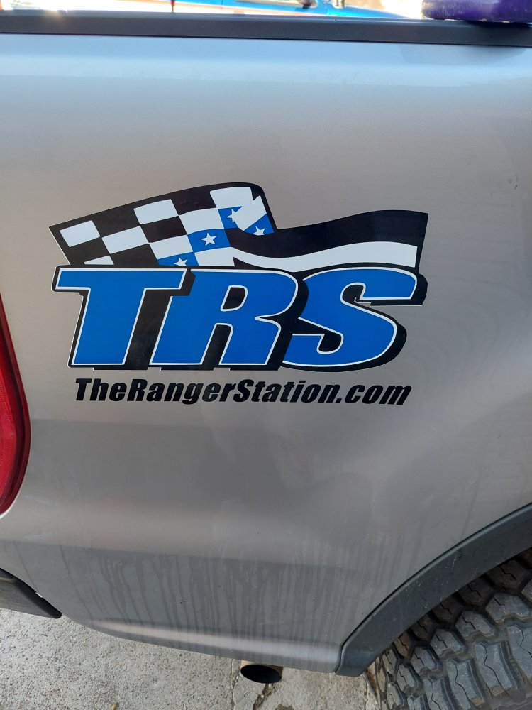

here's the black section down.
Now it's
Last is the red.
Thoughts?
A twin red and blue pinstripe starting at the headlight, sweeping up the fender and straight back to the taillight would be nice.
A blue stripe up the center of the hood surrounded by a red pinstripe would be nice but I think the stars might be a bit much.
