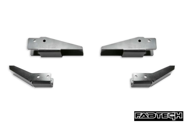

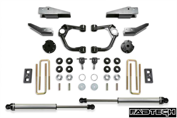

Fabtech offers a 3.5-inch suspension kit that uses strut spacers and new upper control arms but DOES NOT include any brackets to relocate the front differential. Fabtech also offers their kit with new intrusion beams to make room for larger tires.
Fabtech also sells their intrusion beam kit separately.

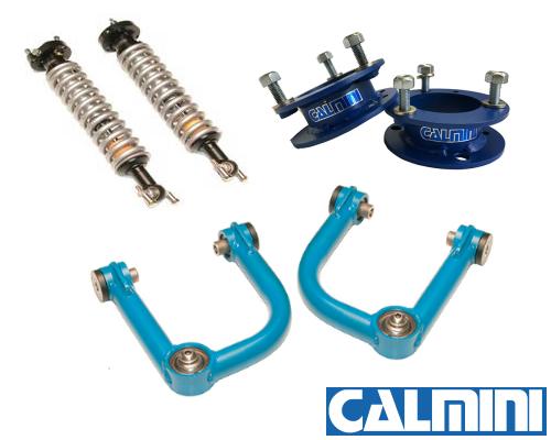

Calmini sells new upper control arms, a strut spacer, and new longer struts. They do not include brackets to relocate the front differential.
Calmini 2019 Ford Ranger 3.5-Inch Suspension Parts

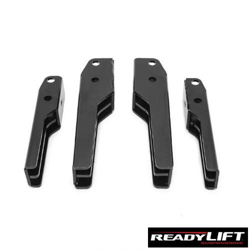

ReadyLift only offers up to a 3-inch leveling kit, but they do offer replacement intrusion beams for more tire clearance.
